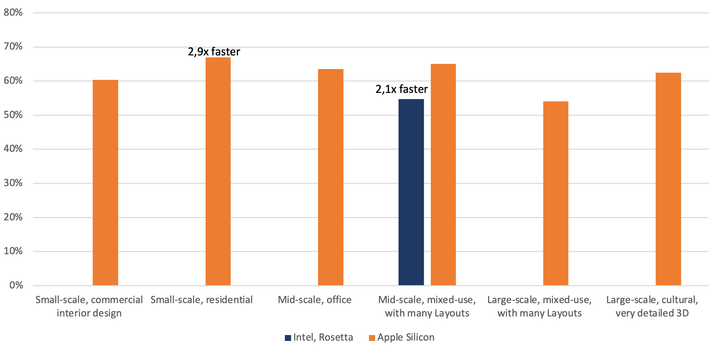

1. Increased 3D performance thanks to the Apple silicon support
BIMx Desktop Viewer performs better in 3D running natively on Apple silicon. Note that the next-generation desktop application is on the corner and will bring even more enhancements early next year! Follow Graphisoft Insights and BIMx News to stay up-to-date.
The graphs below show the 3D performance improvements obtained during the tests, with results in how smooth the navigation experience is measured in Frames Per Second (FPS) while exploring the virtual model and 3D Marker loading in seconds. The baseline values were measured in BIMx Desktop Viewer 4390 Intel running emulated, and the percentages below show how much faster the Apple silicon product is.
For example, a 50% performance increase means displaying all the markers in 1 second instead of 2, or 60 FPS instead of 30 (in other words, a twice as smooth navigation experience).
Higher % values mean better performance.
Running natively on Apple silicon also reduces memory (RAM) usage by up to 30%.
Notes:
  • We made both the navigation and 2D to 3D transition FPS measurements with active Ambient Occlusion (BIMx's real-time rendering), and the Markers were disabled (which were measured separately).
  • Navigation in the test means panning. We used a 1680x1050p display during the measurements. In the case of high-resolution screens and/or retina displays, running natively on Apple silicon may result in a smaller FPS increase.

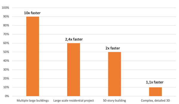

3. Smoother 3D navigation on BIMx iOS
Download the latest iOS application from Apple App Store. This optimization will also be available in the Android application soon.
We introduce a 3D performance improvement for a smoother navigation experience.
It is most noticeable in models consisting of many, mainly simple geometry elements. Depending on model complexity, this update can increase Frames Per Second (FPS) multiple times. Display even hundreds of thousands of simple geometry elements much more efficiently.
  • For example, an urban-size project consisting of 325,000 elements and multiple large (60-80-story) buildings can be displayed with up to ten times higher FPS values reaching 60.
  • On the other hand, the performance improvement is less noticeable in complex, detailed 3D models, including many different and detailed, high polygon number objects (e.g., sculptures in the renovation of a classical cultural building).
  • Less complex 3D models, like in residential projects keep working with the maximal FPS — depending on the hardware.
The FPS % increase measurements below are done in BIMx 4506 on an iPad Pro 2021 with an M1 chip and 8GB of RAM.
The baseline values were measured in BIMx iOS version 4362. The update on iPads and iPhones with less memory and older chips may result in a more noticeable difference compared to the previous BIMx version depending on the 3D models' complexity (element number, element type, polygons).
None of these models needed Data Streaming; BIMx loaded the complete 3D in all cases.
For example, a 60% FPS increase means 60 FPS instead of 24 — almost three times smoother navigation.
See the element numbers, types, and polygon numbers in the mentioned 3D models in the chart below. It presents the ratio between basic construction elements (walls, slabs, etc) and others (furniture, curtain walls, morphs, etc). The polygon/element values highlight why this optimization is so significant in the first model and why it isn't in the case of the other example. The other two models in the diagram consist of 97 000 and 56 000 elements and element/polygon ratios are between the below described two examples.
