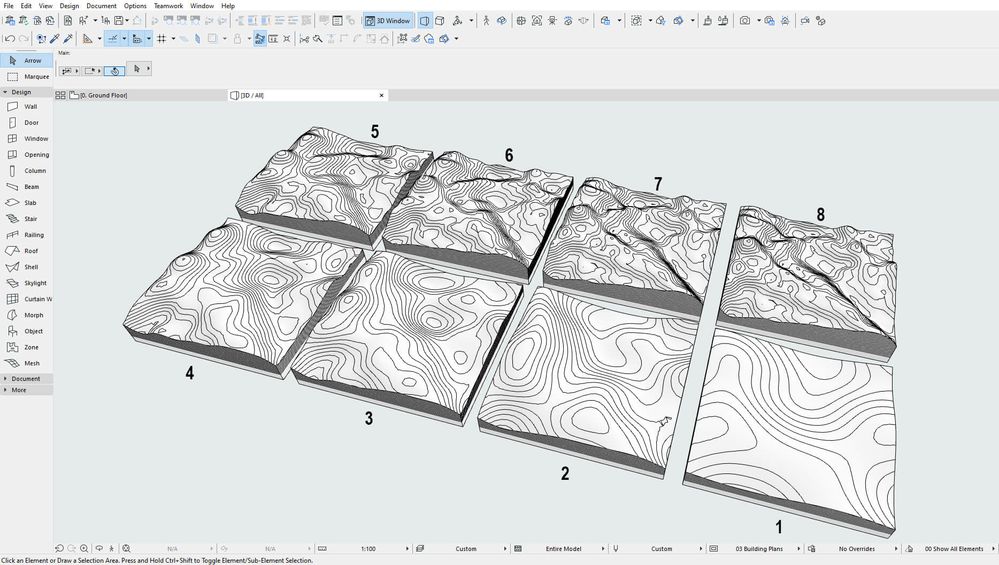

Control terrain detail with octaves
Noise‑based terrain generation uses octaves to stack multiple noise layers on top of each other. As the number of octaves increases, the terrain becomes more detailed and visually interesting, but each additional octave adds another calculation loop, so generation time increases almost linearly and the benefits diminish after approximately 7 octaves.
Comparison of the effect of octave values on the generated resultComparison of the effect of octave values on the generated result
Terrain detail increases with the number of octaves.
  • Use lower octave counts for quick previews and testing.
  • Increase octaves up to around seven for production to balance detail and speed.
  • Several octave settings can be compared side by side in order to select the most appropriate level of detail for a given project.

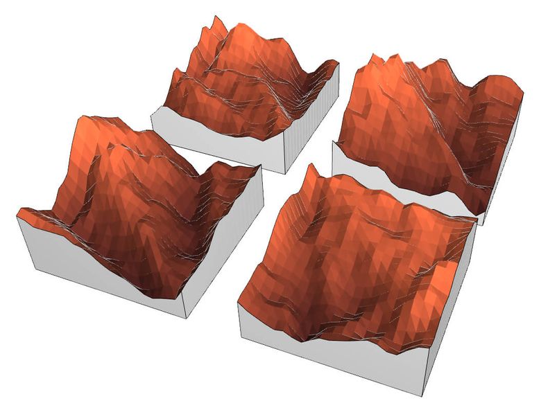

Use permutation tables for pseudo-random terrain
To generate repeatable pseudo-random terrain, GDL uses a permutation table as a lookup table for the noise function. In Perlin-style noise, this table stores a shuffled sequence of values that can be reused to produce consistent results.
Step 1: generate the permutation table in Python
You can generate the table in Python by creating the numbers 0 to 255 and shuffling them. If you use a fixed seed, you will always get the same permutation table, which is useful when you want repeatable terrain.

The permutation table is generated once in Python and then pasted into the GDL script as constant values. Because the randomization step happens only in Python and not in GDL, using this table will always produce the same height map each time the GDL object runs.

For cases where different terrain is needed each time, a simple shuffle algorithm can be used to randomize the lookup table inside the GDL script itself. The distribution is not perfectly even, but it is fast and accurate enough for terrain generation. This way, a new terrain is created from a random lookup table at each placement of the object. If the placed object is moved or rotated, the generated terrain remains unchanged.
Different permutation tables produce different pseudo‑random terrainsDifferent permutation tables produce different pseudo‑random terrains

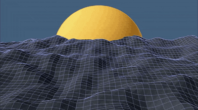

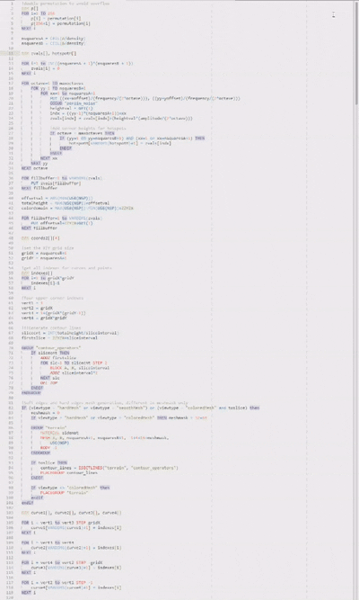

Animate objects with GLOB_FRAME_NR
Objects in Archicad are not moved continuously between frames. Instead, they are rebuilt for each frame of a fly‑through when animation is enabled in the Create Fly‑Through panel. The object cannot store state between frames, so all animation logic must be defined up front and driven by global variables. The main variable for this is GLOB_FRAME_NR, which stores the index of the current frame.
In a noise‑based terrain, the illusion of motion can be created by offsetting the noise field slightly for each frame based on GLOB_FRAME_NR. Because almost any parameter can be expressed as a function of the frame number, many different effects, from particles to surface deformation, can be animated.

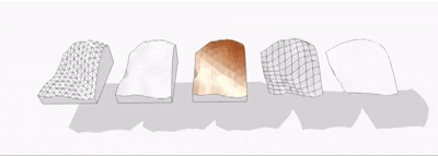

Choose geometry method for terrain
There are several ways to generate terrain geometry in GDL. A simple mesh can be used, colorized triangle pairs can be built, or a smooth NURBS surface can be created. Each method has different trade‑offs in performance, visualization, and texture control.
Left to right: MESH with edges off, MESH with smoothed edges, colorized CSLAB_, merged triangles from PLANE_ with their joint edge smoothed, NURBS surfaceLeft to right: MESH with edges off, MESH with smoothed edges, colorized CSLAB_, merged triangles from PLANE_ with their joint edge smoothed, NURBS surface
Mesh‑based terrain
For many use cases, the simplest solution is to generate a MESH, which behaves in a similar way to the Mesh tool in Archicad. Grid sizes are provided in the x and y directions, and a z value is specified for each node.

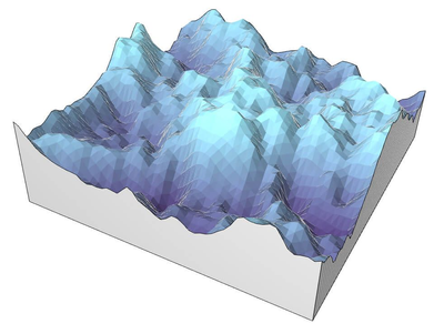

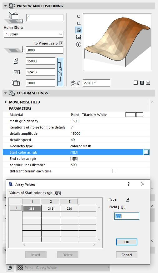

Create a heightmap and color gradient with GDL
To create a height‑based color gradient on the terrain, lower areas are assigned one color and higher areas gradually blend toward another, with the gradient driven by each mesh plane’s z value. The following steps show how mesh becomes a heightmap, with geometry defined by the terrain heights and a color gradient that reveals elevation changes across the surface:
  1. Choose the colored mesh geometry type
    In the object settings, the Geometry type is set to Colored Mesh. This setting instructs the object to store color information per mesh plane, not only raw geometry.
  2. Define start and end colors
    When the color array field appears, the RGB values for the start color and end color are entered.
    • The start color is applied at the lowest z value in the mesh.
    • The end color is applied at the highest z value.
  3. Map height to color in the script
    In the GDL script, the z value of each mesh plane is read and remapped into the 0.0–1.0 range. That normalized value is then used to interpolate between the start and end RGB values, producing a smooth gradient from low to high areas.
  4. Generate materials from RGB values
    DEFINE MATERIAL is used to create a material for each required color. For simple flat colors, the matte material type is used and the interpolated RGB values are passed as real numbers between 0.0 and 1.0 (0–255 values divided by 255). The material is then applied to the current mesh element with  MATERIAL.

In this example, the pattern uses  RND  to randomize each color channel while keeping values in the 0.0–1.0 range after dividing by 255, so each blade of grass gets a slightly different shade of green for a grass‑like material. 
Grass‑like material generated with random color variation in GDLGrass‑like material generated with random color variation in GDL
