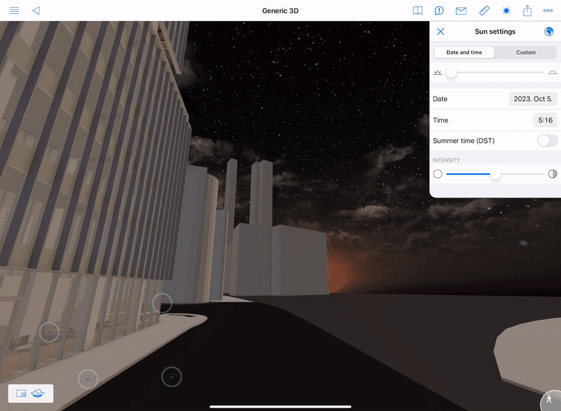

Sun positioning by date and time is now available in the sun settings palette on all platforms, with an enhanced, dynamic skybox:

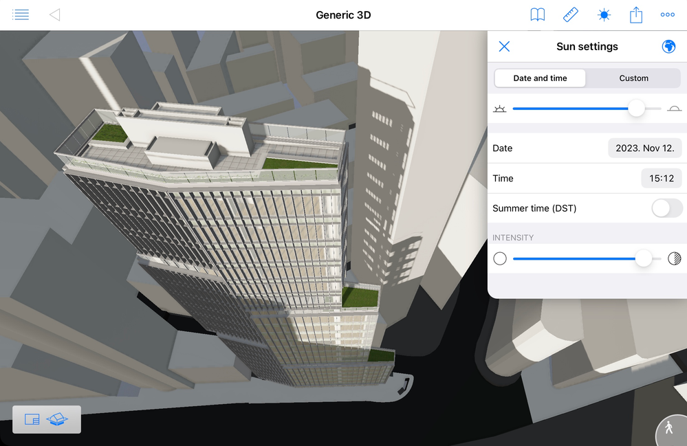

Open the sun settings and switch to the date and time side of the palette from the custom option to explore the virtual model with an even more realistic 3D representation. BIMx displays sun movement set to a path aligned with the project location. The height of the palette is adjustable on iPhones and Android smartphones so that you can see the 3D model on your preferred screen area and control the sun position simultaneously.
  • Move the time slider between sunrise and sunset to display real-time moving and accurate shadows on the building and the neighboring areas. The two endpoints of the slider are aligned with location settings, time zone, and the Summer time toggle.
  • Use the date picker to see how sunlit areas change between the Summer and Winter solstices. Shadows align immediately to the selected date.
  • The numerical display of time is synced with the time slider. You can use either of these to pick the desired time.
  • Activate the Summertime toggle if +1 hour daylight saving is valid in your location on the selected date. This toggle won’t override the time zone.
  • Adjust shadow depth with the intensity slider.  The default shadow intensity has been adjusted from 100% to 50% to fit most scenes better.

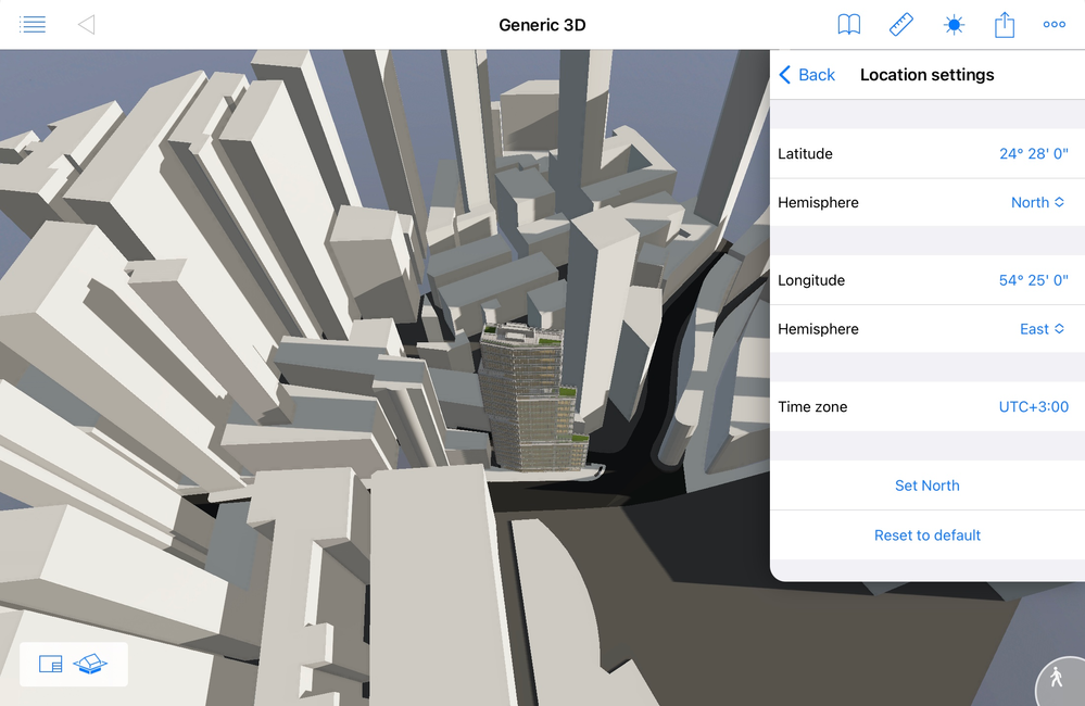

Location settings:
This palette is available by tapping on the globe icon in the top-right corner of sun settings. If the Hyper-model has been exported with the proper location settings, no adjustments are needed here. More details are in the How to prepare the Hyper-model section below.

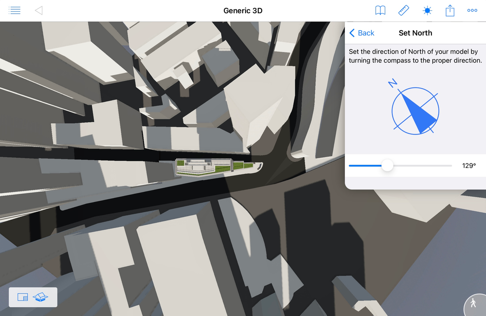

You can also change the North angle in BIMx. The app animates to a top view:
If you need to change the North angle in BIMx, we recommend projecting the 2D site plan to 3D by opening the relevant layout and tapping the 3D icon.
‘Reset to default’ reverts the location settings to the original values defined before export.

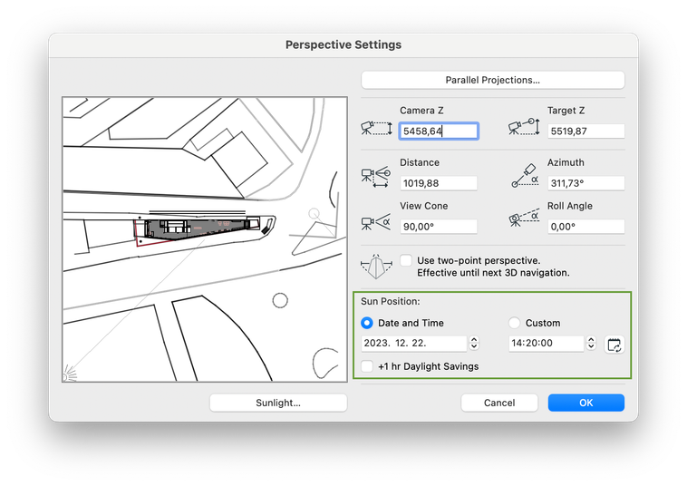

How to prepare the Hyper-model in Archicad
To get the proper sun settings in BIMx, ensure the Hyper-model has been exported with the project’s geographical location, time zone, and North angle. Read more about adjusting these settings in the Archicad user manual. The following settings affect shadow representation in BIMx:

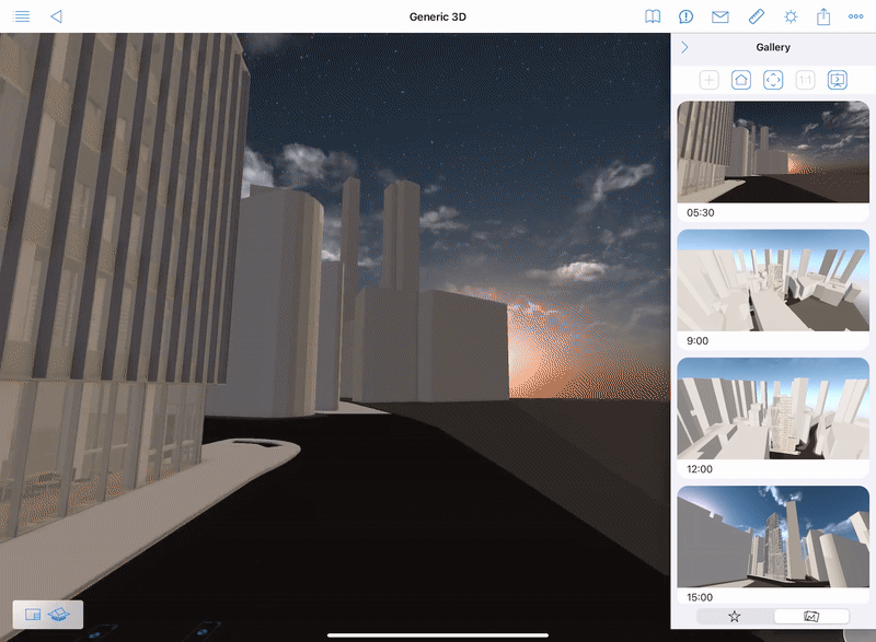

RolandSzabo_5-1686560586847.pngSet Cameras in Archicad with different sun settings! When switching between gallery items in BIMx, not only the camera but the shadows will also move with animation:
