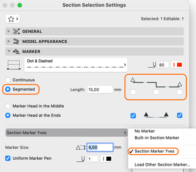

  1. Install the custom marker object
  2. Set the custom marker as default
    • Open the Section tool settings.
    • In the Marker settings, select the installed custom Section Marker object as the marker type.
    • Store this configuration as a Favorite if recurring use is required.
  3. Place sections with the custom marker
    • Place sections as usual with the Section tool on the floor plan.
    • The custom marker will generate regular section views and maintain standard 3D links and updatable drawings.
  4. Adjust marker symbols independently
    • On the floor plan, select the section marker.
    • Move or offset the marker end symbols as desired, independent of the 3D cut line extent.
    • If the visual line between the symbols and the true cut line is no longer desired, hide the original section line and use the marker’s own linework instead.
  5. Handle graphical limitations
    • If the marker symbols are moved closer or farther than the original extents, the section line may no longer visually connect to the heads.
    • In such cases, hide both ends of the standard section line and manually adjust the custom marker’s lines for a clean graphic result.

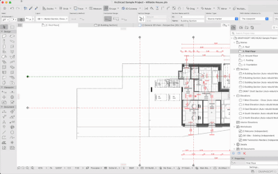

  1. Create the real section
    • With the Section tool, place a standard section marker that defines the true 3D cut line and generates the section view.
    • Adjust the marker’s length to include all necessary model details for documentation.
  2. Hide or isolate the real marker
    • Assign the real section marker to a dedicated layer if separation on the floor plan is required.
    • Hide this layer in relevant floor plan views, or set the marker display so the marker is invisible in plan while still generating the section view.

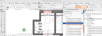

  3. Place linked section markers on the floor plan
    • Activate the floor plan view where the simplified graphic is needed.
    • Use the Section tool and set the marker type to Linked Marker in the tool settings.
    • Draw the linked marker line in the desired position and with the desired marker length on the floor plan.
  4. Link the marker to the existing section
    • In the marker’s settings, choose the marker reference option to link to an existing viewpoint, view or drawing.
    • Select the already created section view (or layout drawing) that represents the real section cut.
    • Confirm the settings so the linked marker displays the information of the chosen section.
