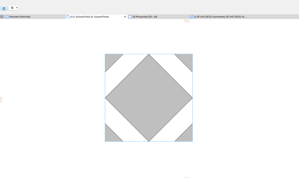

  1. Draw a pattern
    • In any 2D workspace, use the Fill tool alongside other drawing tools to compose a pattern with lines, arcs, hotspots, and at least one fill element. Select and group all elements to keep the pattern intact.

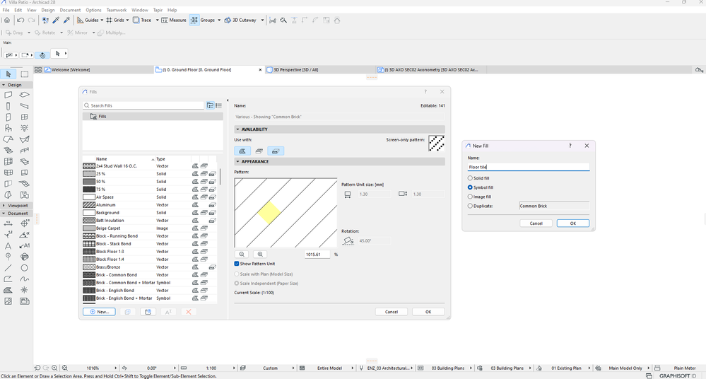

  4. Create a new symbol fill
    • Click on New, select Symbol Fill as the fill type, and open the Symbol Fill editor.
