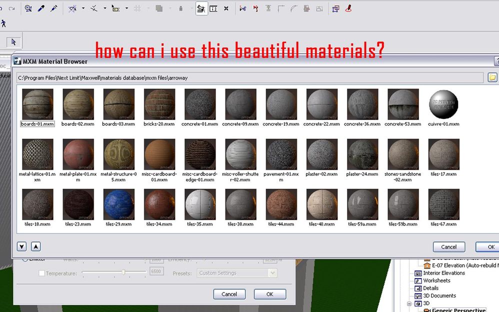

I try to use the material of maxwell, I do:
1- material settings box;
I duplicate an archicad material
2- I select "Maxwell material" in the box and I load the material (see attachement)
3- I apply the new material on my wall by "wall selection settings" (but its the materiel duplicate of archicad who appear)
4- I start the render and its a message error in maxwell:
ERROR: - File "C:/Program Files/Next Limit/Maxwell/materials database/textures/arroway/metal+plate+01_d100.jpg" has not been found. Render cannot continue.
ERROR: - Render Failed
5- I realised that my material is NOT a JPEG but an MXM...
6- I feel stupid...
So, what is the good move to apply the material of maxwell in ARchicad?
In the 2 attachement, i place the box material that I would like use.
Excuse for my english.... I talk french....

I watch the movie and I choose a path for my texture in the material editor but now, when I start the render I have an other error:
[07/April/2009 13:40:26] Checking Data
[07/April/2009 13:40:26] Loading Bitmaps & Preprocessing Data
Do you know what it is?
