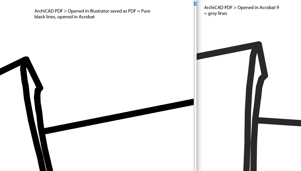

I've saved a ArchiCAD layout in both black and white and greyscale then opened it in Arobe Acrobat Pro.I then took the same file and opened it in Illustrator then from I llustrator saved it as a PDF (no edits made)
Below is a screenshot of both files, one directly from ArchiCAD PDF export and opened in Acrobat. The other which has darker lines was exported in the same fashion but them saved as PDF in Illustrator.
Why does this happen? If I want true black lines must I save as PDF, open in Illustrator the save as PDF again?

I have only used black lines though, this what I don't understand. I also don't understand how by opening the same PDF in Illustrator, then saving it as PDF, makes the lines appear ' full' black...

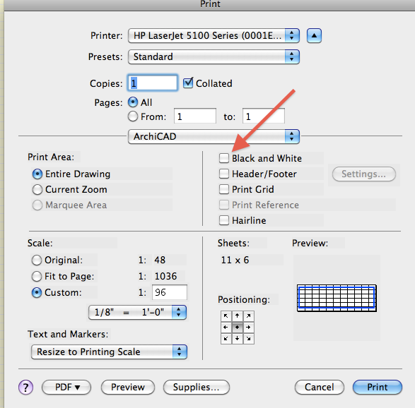

You are certain that your pens are really black and not just something close? If you edit the pen color in RGB the RED GREEN and BLACK sliders are all 0 not just near 0?
Another possible option is to check the Black and White check box in the print dialog.
(sorry I can't speak the the illustrator issue.)
Nope, it's definitely a black pen colour. The files is a .pla (archive) and the elevations (which have the issues) are unlinked, not that it should make a difference?
On paper things seem black, but on screen when you zoom in (PDF) it is not black.
