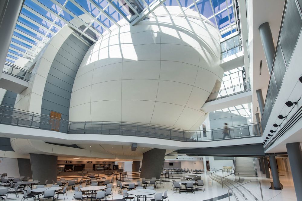

Duke Ellington School of the Arts
Architect: cox graae + spack architects | LBA Joint Venture
Photo © Chris Ambridge
