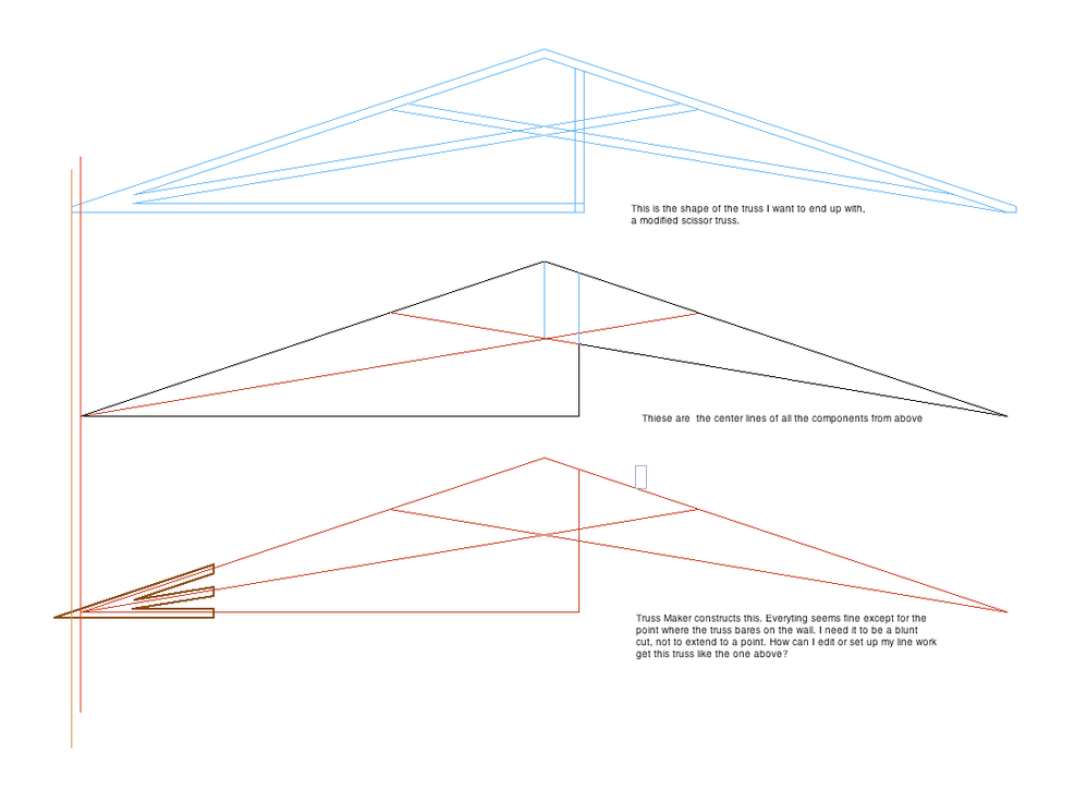

I'm trying to make a truss and I can't get it right. I need it to not extend past the 2 x 4 on which it bares.
I've attached a picture, I hope it helps. Any help would be greatly appreciated.

Hi Chris,
I'd go for a complex profile. I however depends a little on how you want to show the trusses in plan view.

That's a good point!
Being that I'm still in 'traditional drafting mode' I'm not sure how I want to see it in plan. Normally I would, in plan, show the rafter tails as part of the truss because it's at such a small scale it doesn't really matter. Then I would show the truss in section and then detail the rafter tails connections to that truss.
This being AC and 3D, is there a modous operandi? I think I want the trusses to show exactly as you have them so that they show correctly in section.

Unfortunately, Chris is using the Start Edition which does not support complex profiles.
Cheaper than upgrading to full AC is adding objectIve to the mix, as it can do the same thing...and more (other than profiled walls):
http://www.encina.co.uk/objective.html
Cheapest is the old-fashioned way of magic wanding the truss outline on the floor with the slab tool, viewing the result in the 3D window from above, and saving as a GDL object.
Not sure if a solid element subtract will cut the pointy tails off of the TM-created trusses.

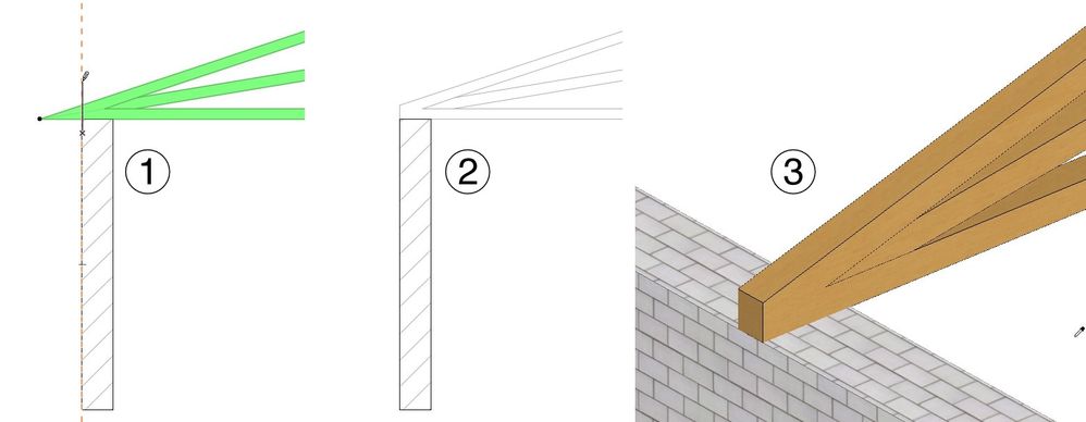

In addition to providing the profiling tools, OBJECTiVE has tools that can cut the pointy tails off TM trusses too - referring to the attached image:
  • 1) Use OBJECTiVE's Split tool to cut off unwanted portions
    2) The remaining truss - the offcuts have been deleted. The remaining object is still a TM truss exactly as before, i.e. it hasn't become a dumb 3D 'blob' in the process. Unlike SEOs it also looks right in the plan view.
    3) The result in 3D.
