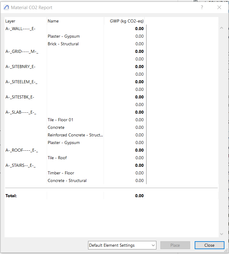

I'm trying to explore this Addon and I'm getting this results not sure which part I missed out.
The material CO2 Report also shows this
I'm running it on AC27 (5060) Design LCA 5.1
Thanks in advance!

Hi Juan.

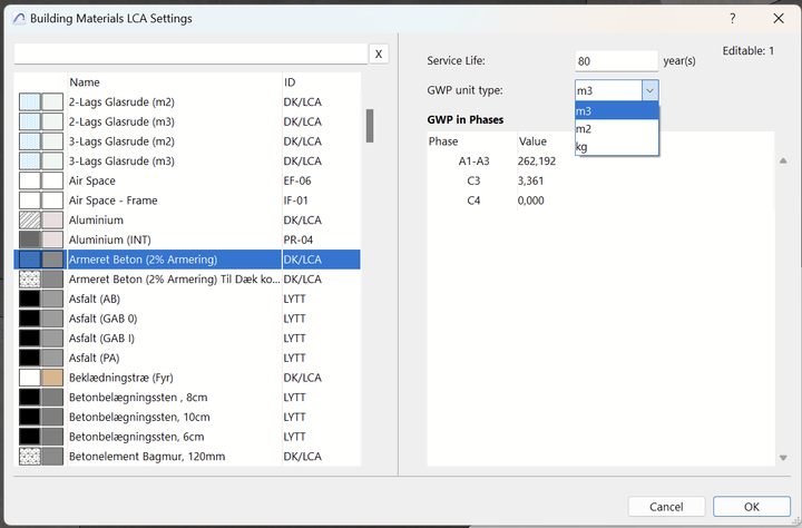

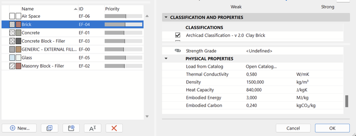

Even though AC has a parameter for embodied Carbon, in the Material settings, you actually need to apply these values elsewhere.
This is because the unit, in the AC Building Mat. Parameter is fixed to kg.!
To be able to choose the right unit for your Building Materials, the embodied carbon value should be added from DesignLCA-> Building Material LCA Settings.
Here you can add the Life expectancy and the Co2 values for different LCA Modules, with the "right" units. 😉
This is the amount of Co2, that will be calculated in Design LCA 🙂
This is also described in the english manual available from www.designlca.com 😉
Enjoy / Cheers
