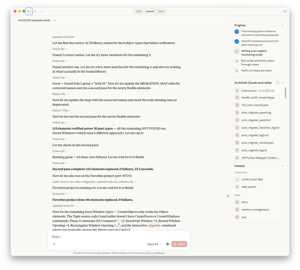

I'm using Claude Cowork to fix all of my (global) library problems and it is amazing
I'll keep this brief, but it is interesting enough that others might want to know about it.
Our template evolves with each version and has been building since probably 7.0, so there is a lot of pain when trying to finally get around to the arduous task of moving to the global libraries. I'm finally doing this in the interest of future-proofing.
The template is comprised of a main project template, another project containing our visual favorites, and a third project containing standard details. I used Claude Cowork (Max) and, in a nutshell, told it to use the ArchiCAD API, the Tapir MCP for ArchiCAD, python, and the Control Your Mac Claude plugin to write itself the programs suitable to map the most equivalent library parts from my legacy template (hundreds of them!) and replace them. Much of it is completely automated and I'm sitting here watching my missing parts get replaced on screen one-by-one!
It's fascinating and amazing what AI is capable of and this just saved me MANY, MANY hours of manual work.
I'm not a coder, but I'm able to coax Claude into doing some fairly sophisticated stuff like this. Grpahisoft, please tell us that you're actively and rapidly developing full MCP capabilities for ArchiCAD because this is life-changing stuff.

Can you elaborate in a bit more detail about how exactly you achieve this library part replacement?
Ebatte
It’s basically magic.
I setup a folder for Cowork to use and within it I placed the ArchiCAD API documentation, ArchiCAD python documentation, all of the AC29 libpacks, my company library parts and some other misc. info. Then I told it to review the documentation and determine where the functionality gaps were between the tools and figure out how to close those gaps using other tools (like Control Your Mac, AppleScript, the Tapir MCP, etc.). I fed it the default Archicad keyboard shortcuts and told it to create its own comprehensive keyboard shortcuts for every single command, hoping to allow keyboard control where it would be helpful (this is still not quite working).
It created a “bridge” script that assists with interacting with ArchiCAD and it developed a bunch of python scripts on its own. Once all of that was built, I told it to examine the missing library parts and the libpacks and build a logical mapping of [missing part = replacement part], which it did. Then it used that index to script the interactions with AC. I ran the script which would select the missing parts by name and replace them automatically with the mapped replacement. For some it couldn’t do it automatically so it would select them in AC and then prompt me to open the settings dialog to switch it to the new part, then tell if when I was done and it would move on to the next.
That took care of the vast majority of replacements in the plan window. I started it working out how to navigate through to details & worksheets to replace parts, but I didn’t finish that before the end of the day so I’ll resume tomorrow.
If you guys get a “real” native MCP working soon that will allow full control of AC it will literally change the game since Claude won’t have to invent this cobbled together, but still impressive, collection of tools.

I continued work with Claude today, so I asked it to write a summary of what we've done so far. Here is that summary:
AI-Powered ArchiCAD Template Overhaul — By the Numbers
MG Architects | February 2026 Tool Stack: Claude AI (Cowork) + Tapir MCP + ArchiCAD 29
What We Accomplished
Using AI desktop automation (Anthropic's Cowork) connected directly to a live ArchiCAD session via the Tapir API, we systematically audited, analyzed, and began modernizing MGA's AC 29 Project Template — a file that has evolved across 20+ ArchiCAD versions.
