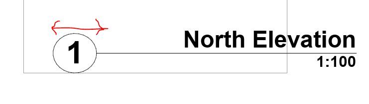

I've made my own drawing title for custom library test.
and found some problems.

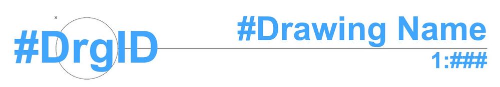

1. The shape of drawing title is different with what I made.
2. can't select and move when there are drawings in one layout, one drawing in one layout is different story(selectable and movable).
I'm attaching 'pln' file.
a month ago
Hello,
Try this:
1:
Open the title object and in the 2D script, write
FRAGMENT2 ALL, 1
2:
In the object settings, remove the red cross for manual position and set the parameter to yes
