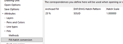

Hi all,
I am wanting to import a DWG Drawing and have the Solid fills replaced by 25% fills, but I am not getting an option to pick a translator when I place the DWG, and nothing seems to change if I set the translator that I want as the default for importing beforehand...
Ling.

Do you mean set a Template file in the Save Options page of the Translator?
A Template is relevant only during DWG Export.
runxel
I had the same issue today. It looks like it's completely ignored when you place a DWG as a drawing and then think about exploding it into 2D. (Which is kinda mad.)
Lingwisyer
Guru
No. I am placing a dwg file from a consultant as a Drawing and am wanting the aCAD Solid Hatch to come into AC as 25% Fill.
