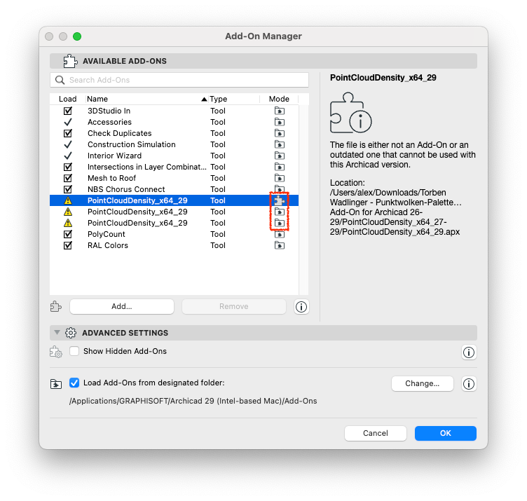

I also came here after the Graphisoft email, very interesting.
Sadly, I haven't been able to load and use the Add-On, either the v26 in Archicad 26 or the v29 in Archicad 29. On macOS Intel.
I did use Xattr (thanks for the tip, @torben_wadlinger ) but the best I could achieve is for the Add-On to appear in the Add-On Manager list with the yellow triangle and the warning:
"PointCloudDensity_x64_29 -
The file is either not an Add-On or an outdated one that cannot be used with this Archicad version.
Location: /Users/alex/Downloads/Torben Wadlinger - Punktwolken-Palette… Add-On for Archicad 26-29/PointCloudDensity_x64_27-29/PointCloudDensity_x64_29.apx"
If someone can point me to what I have done wrong, please do, much appreciated.
I did try to add it by placing the .bundle file at various locations but I always got the yellow triangle. Only the icon at right on the add-on row within the manager window changed.
Location: /Applications/GRAPHISOFT/Archicad 29 (Intel-based Mac)/Add-Ons/Torben Wadlinger/PointCloudDensity_x64_29.apx
Location: /Applications/GRAPHISOFT/Archicad 29 (Intel-based Mac)/Add-Ons/PointCloudDensity_x64_27-29/PointCloudDensity_x64_29.apx
Screenshot below from Archicad 29 Intel Mac.
Archicad 29.0.2 (3200) INT; macOS Sonoma

Sorry, the problem is on my side. The Addon is too old and it's not notarized, because I have to buy an Apple Developer Account. Please be patient - I will upload a notarized version as soon as possible.
