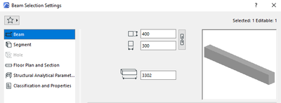

Hello,
I would like to get a beam element geometry information like width, height, length and reference line position. I am fine with the length as I can calculate from reference line coordinates, but I did not find information about width and height in API_​BeamType nor in its memo.
I am looking for the 400 and 300 values in case below in the API.

Hello there,
It's in the assemblySegmentData member, in nominalWidth and nominalHeight.
Best, Akos
