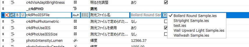

I checked the parameter on GDL Object Editor, and noticed that its type is not a simple string but a list of selectable strings (which is called a "value list" in ARCHICAD terminology?)
"test.ies" is certainly in the list, but it doesn't seem to be able to select it by simply setting a value to the parameter. Can you suggest me how to deal with this type of parameter using the API?
