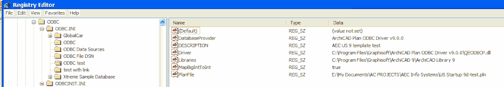

You're welcome; and I agree.
I just did a Google on 'programmatic system dsn' and among other things came up with this:
http://www.databasejournal.com/features/mssql/article.php/1491051
and the registry hack seems like a potentially reasonable work around.
On my XP Pro system, the system DSN entries are found at:
\HKLM\Software\ODBC\ODBC.INI\
Screenshot below shows the contents of an old DSN called "ODBC test" from the AC 9 version of the driver. Note that the key "ODBC Data Sources" must also contain a link (index) to point to this entry.
Maybe this will work? Report back here if so to help the next guy...

Got it sorted but I'm just in the office...those typos!!. You can do a standard dsn less connection...its just that I copied the connection string example from the help file which is "V1.0" not "V10.0" and so it went under the radar for a little while.
This codes works well for auto dsn generation when attached to the form open command;
http://www.vbforums.com/showthread.php?t=358864
and its quite terse. I discovered also that there is direct registry editing throught the getsettings of vba. More than one way to skin an archicat!
Standard ADO with connection string is by far the best alternative though.
