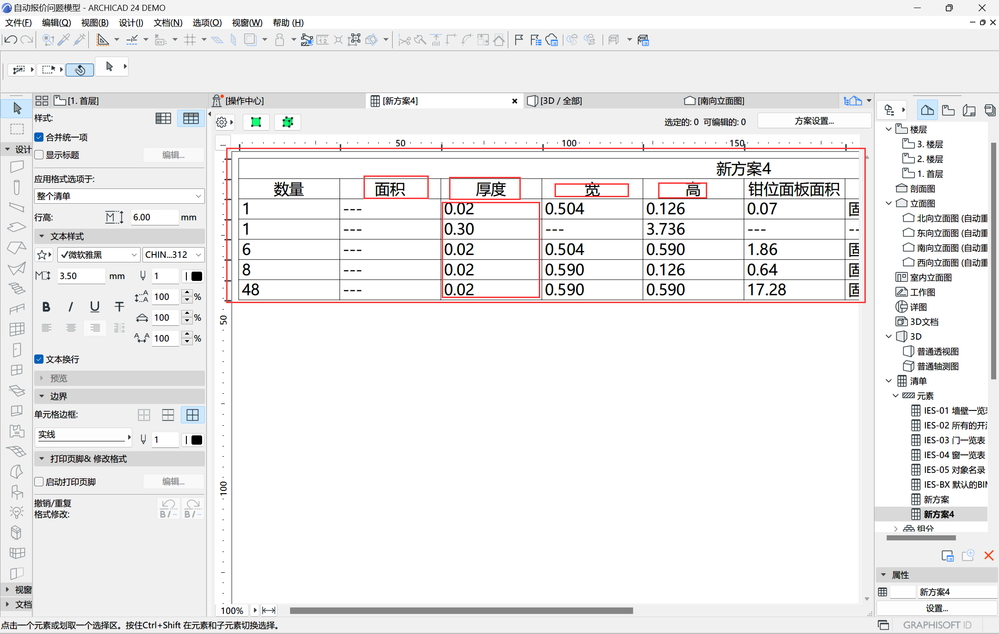

I am currently working on plugin development for ARCHICAD, I want to obtain some data for the current project from the worksheet created by the user.
Can you provide some suggestions on which API to use?
A more detailed version would be better. ^^
Thank you. ^^

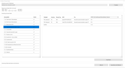

i had to do the same: implement my own version of the schedules. that really sucks since there has to go a lot of development time in to that. but on the other hand it allows you to implement a schedule version that suits you're use case the best. i built a add-on for quantification for a construction administration programm. i added a selection management like solibri, that you can add properties and other stuff: so good thing is, you can develop a schedule system that suits your requirements bestwise 🙂
some tipps i wished i knew before:
1. api calls are costly, how ever you plan to implement your schedules, you have to outline your architecture that you do as less as possible api calls.
the answers from @BerndSchwarzenbacher in this post: https://community.graphisoft.com/t5/Developer-forum/Fastest-way-to-query-Database-for-specific-User-... helped me a lot.
2. the api error codes are somethimes hard to get something meaningfull out of them. best way is to take a call that works and customizing untill you break it and never go full in.
hope that helps a little..
