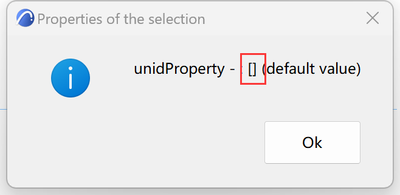

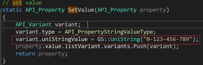

I created a property for an element using the ACAPI_Element_SetProperty(guid, property) method and assigned a value to it using the following method.
Next I use the following method to add the properties created above to the other elements.
The problem is that only the first element has a default value, and the element with ACAPI_ElementList_AddProperty(property.definition, guidArrary) has no default value.
I tried it out using the ACAPI_ElementList_ModifyPropertyValue method, as shown below.
My question is how do I change the value of an attribute of an element. Please give me some help with this.
thank you.

P.S.
This is a property added for other elements and does not have the value I set.

Might be a little late, but for a single element try using ACAPI_Element_SetProperty

Yes, I am using it.
Thank you!
