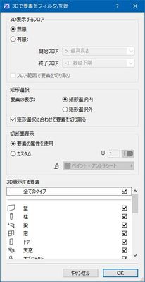

So what I'm interested in is not the shape of the selection marquee, but the shape of the currently active 3D filter.
HKM
The shape of the 3D filter will be maintained indefinitely until you press the [F5] key again.
I would like to know the shape of this maintained 3D filter.

HKM
Create a view cropped with the 3D filter.
Whenever you call up the view you created, the 3D filter will be recreated.
The selection marquee doesn't matter in this case.
I would like to know the shape of the 3D filter.
OK, so you are not talking about simply viewing a marquee crop in 3D.
You want the actual crop that is stored when you save a view in the view map.
I can't help you with that as I know nothing about API, just trying to clarify what you want.
I was under the impression you just wanted the marquee shape from the plan, which I think is what Ralph was thinking as well.

Ralph Wessel
Following up on Barry's observation, can you confirm that you want the cropping stored with a 3D view stored in the Navigator? And applied according to the View setting (as shown in the attached snapshot (under marquee effect)?

HKM
It has the same settings.
