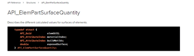

Hehey evryone. I hope my question has not allready been answered.
i want to get the diferent surface areas of a element.
Example: I want to get the blue and the yellow surface area separately
basically the functionality the surface schedule does:
but im not seeing any API functions that are working with surfaces and elements.
i looked in the element quantity structs and im not seeing any connection to surfaces.
am i missing something?

ReignBough
ACAPI_Element_GetSurfaceQuantities

"i looked in the element quantity structs and im not seeing any connection to surfaces"
next time i look better... xD
