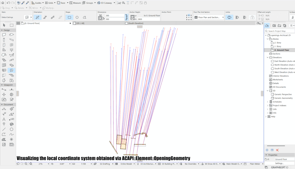

According to the Archicad 29 API documentation, the methods OpeningGeometry::{GetVectorX | GetVectorY} should return the x and y base vectors of an opening's local coordinate system, while OpeningGeometry::GetExtrusionDirection should return its direction vector.
Based on these descriptions, I assumed that these vectors form a local right-handed orthonormal coordinate system whose origin is given by OpeningGeometry::GetAnchorPoint.

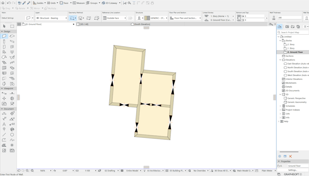

I ran several tests using rectangular openings placed in straight or polygonal vertical walls (API_WallTypeID::APIWtyp_Normal and API_WallTypeID::APIWtyp_Poly) with the Aligned constraint (Constraint::Aligned). In some cases, the vectors indeed form an orthonormal basis, but in many others they do not. This is unexpected, because in earlier APIs the local coordinate system was always orthonormal and could be reliably obtained from API_OpeningType::extrusionGeometryData.frame.axis{X, Y, Z} and API_OpeningType::extrusionGeometryData.frame.basePoint, where frame was an API_Plane3D. Moreover, frame.axisX was parallel with the owner wall surface under this constraint.
Since API_OpeningType is deprecated and no longer available starting with the Archicad 29 API, we now rely on the classes ACAPI::Element::{Opening | OpeningDefault | OpeningExtrusionParameters | OpeningFloorPlanParameters | OpeningGeometry} and their modifier classes to maintain compatibility with Archicad 29+.
My question is: Is the non‑orthonormality of the returned vectors intentional, or is this a bug in the current API? If intentional, what is the correct way to reconstruct a stable local coordinate system for openings?
I also experimented with Gram–Schmidt orthogonalization, but the resulting right/up axes are not guaranteed to align with the vertical owner wall of the rectangular opening, which makes the approach unsuitable for my use case.
For reference, here is the code I used to retrieve and orthonormalize the vectors:

Does anyone know the intended behavior of these vectors in Archicad 29, or how to correctly derive a consistent local frame for openings?

2026-03-11 02:53 PM
I've asked a developer to look into it.

2026-03-11 07:53 PM - edited 2026-03-11 10:37 PM
To help with debugging, I have prepared a small project file together with a short animation that demonstrates several polygonal walls with openings whose local coordinate systems appear inconsistent. Alongside the file, the following minimal code snippet can be used to inspect the vectors returned by OpeningGeometry for every opening in the project.

2026-03-12 12:28 PM - edited 2026-03-12 06:31 PM
Concerning the local coordinate system of openings, I would like to propose a correction to the Archicad 29 API, based on the technical details and source code presented below.
The function RetrieveOpeningLocalCoordinateSystem constructs a stable, right‑handed orthonormal local coordinate system for openings placed in different types of walls. At this stage, the correctness of the coordinate system provided by ACAPI::Element::OpeningGeometry has not been verified for other types of owner elements that can also host openings. These elements may exhibit the same geometric inconsistencies observed in walls. If that turns out to be the case, the algorithmic steps shown here — or an analogue adapted to those element types — could help guide corrections in the Archicad API (version 29 and possibly earlier).
When the opening is placed in a wall, the function refines the local right axis so that it aligns with the wall's actual geometric direction:
Currently, the up axis is forced to world‑Z under the assumption that walls are vertical, and the forward axis is reconstructed via cross product to maintain an orthonormal, right‑handed coordinate frame.
If the opening's parent element is not a wall, the function currently returns the coordinate system derived directly from the opening's own geometry without applying any correction. This separation is intentional: other structural elements capable of hosting openings have not yet been evaluated for similar issues. Should they exhibit the same inconsistencies, the correction logic used for walls may need to be extended to them as well.
For walls, this approach yields a consistent, wall‑aligned local coordinate system for openings, as illustrated by the animation below (before and after correction).

2.3 Test/visualization
The function shown below is a small diagnostic tool used to visualize the corrected local coordinate systems of openings in the floor plan. It retrieves every opening in the project, computes its refined local coordinate system using RetrieveOpeningLocalCoordinateSystem (), and then creates two arrows at the opening's anchor point:
This visualization is the basis of the "before" and "after" images included in the animation above. It demonstrates how the proposed correction improves the accuracy and consistency of the local coordinate system returned by the Archicad 29 API for openings placed in walls. The tool does not modify the model; it only draws temporary arrows so that the corrected axes can be inspected directly in the plan view.
GS::ErrCode TestLocalCoordinateSystemOfOpenings ()
// Token required for ACAPI::Element::Opening::Get
const API_Token token = ACAPI_GetToken ();
using namespace ACAPI;
using namespace ACAPI::Element;
// Collect all openings in the project.
// These will be used to visualize their corrected local coordinate systems.
GS::Array<API_Guid> openingGuids;
GS::ErrCode err = ACAPI_Element_GetElemList (API_ElemTypeID::API_OpeningID, &openingGuids);
if (err != GS::NoError) {
return err;
// Pen colors for drawing the axes:
// blue: corrected right-axis (wall segment direction)
// red: corrected forward-axis (extrusion direction)
const short bluePenIndex = 6;
const short redPenIndex = 20;
// Wrap drawing operations in an undoable command.
err = ACAPI_CallUndoableCommand ("Draw local coordinate systems", [&] () -> GS::ErrCode {
for (const API_Guid& guid : openingGuids) {
// Retrieve the opening element.
Result<Opening> openingResult = Opening::Get ({guid, token});
if (openingResult.IsErr ()) {
return openingResult.UnwrapErr ().kind;
const Opening& opening = *openingResult;
// Compute the corrected local coordinate system.
// This is the function whose behavior is illustrated in the
// "before" and "after" animation in the forum post.
std::optional<CoordinateSystem> optionalCoordinateSystem =
RetrieveOpeningLocalCoordinateSystem (opening);
if (!optionalCoordinateSystem.has_value ()) {
return GS::Error;
const CoordinateSystem& coordinateSystem = *optionalCoordinateSystem;
// Extract origin and axes.
const Cartesian3& o = coordinateSystem.origin;
const Cartesian3& r = coordinateSystem.right;
const Cartesian3& f = coordinateSystem.forward;
// Compute endpoints of the drawn axes.
Cartesian3 wallSegmentDirectionEnd = o;
wallSegmentDirectionEnd += r;
Cartesian3 extrusionDirectionEnd = o;
extrusionDirectionEnd += f;
// Create the corrected right-axis (blue).
GS::ErrCode err = CreateArrow ({o[0], o[1]}, {wallSegmentDirectionEnd[0], wallSegmentDirectionEnd[1]}, bluePenIndex);
return err;
// Create the corrected forward-axis (red).
err = CreateArrow ({o[0], o[1]}, {extrusionDirectionEnd[0], extrusionDirectionEnd[1]}, redPenIndex);
return err;
return GS::NoError;
return err;
