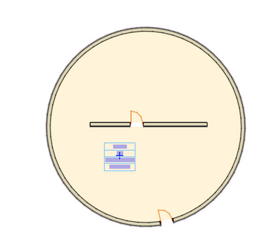

I think some parameter or its combination is wrong. The following code snippet works for me (if the doors are connected to the Zone/Room). The code snippet is based on the Element_Test example addon's source (Do_DumpZone method).
API_Element			element = {};
if (!ClickAnElem ("Click a zone", API_ZoneID, nullptr, &element.header.type, &element.header.guid)) {
	WriteReport_Alert ("No zone was clicked");
	return;
WriteReport ("Doors connected to the selected room:");
API_RoomRelation	roomInfo;
GSErrCode err = ACAPI_Element_GetRelations (element.header.guid, API_ZombieElemID, &roomInfo);
if (err == NoError && roomInfo.elementsGroupedByType.ContainsKey (API_DoorID)) {
	for (const auto& id : roomInfo.elementsGroupedByType[API_DoorID]) {
		WriteReport ("%s", APIGuidToString (id).ToCStr ().Get ());
The output is:
05958BF9-E5F0-3046-8BDD-12C0EE5E501B
7C23555D-563A-D940-838C-4B85C1DE4CFE
For this zone/room:

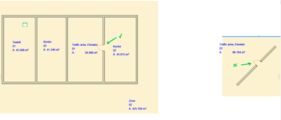

Thank you mszaraz - I have been busy attending other tasks for a while, so I was only recently able to get back to this one.
While the code snippet gave me very valuable insight into how I might potentially improve our current code, it did unfortunately not work with my example model.
In accordance with your suggestion, I am doing this in my code:
ACAPI_Element_GetRelations(zoneGuid, API_ZombieElemID, &roomRelation);
if( roomRelation.elementsGroupedByType.ContainsKey(API_DoorID))
I never get into the if-block for the zone where the door is place in the middle. However for the zone where the door is attached to the bounding wall, the if-block does get activated.
Could there be some other conditions for getting this right in the model? I noticed that the model in your example contains a bounding wall on the zone, whereas my model has a “raw” zone for that part of the model.
Here is a screenshot of my model:
Any further suggestions are much welcome.
