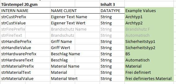

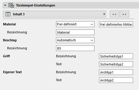

Hello.
I was hoping to get some clues as to the best approach for getting Door Label/Stamp Attributes with the API. The infos I am trying to get are in this linked picture (Doorstamp->Settings->Content3->...)
It is not clear to me wether these informations should be within the door object/libpart or in the stamp/label itself. My guess is that they are actually stored in the stamp/label settings. I do not know however how to get a handle to this from the door.
Anyone has experience with this? Any suggestions would be greatly appreciated.

Update 2:
From my interpretation of the API Documentation, these informations should be actually delivered by the ACAPI_​Element_​GetMemo function but this is not the case:
Returns the gable data1 and the parameters of the instance of a library part*, also the window / door orientation text in textContent.
*The parameters of an element are the parameters of its originating library part, their values are taken from the actual instance.
These are the attributes that I am looking for (AttributeDetails.PNG)
Any suggestions please?

Hello,
You can get the associated Door Stamp's GUID from the Door element, it's the element.door.openingBase.markGuid member.
After that, you can simply query its memo using ACAPI_Element_GetMemo with that GUID to get the parameter list of the
marker element in the memo.params member.
This way you'll get the parameters of the stamp related to the door, not the parameters of the door itself.
