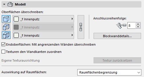

I was wondering if i had access to the "Junction Order" ("Anschlussreihenfolge" in the picture) value a wall has.
I can't find it under API_WallType and it isn't part of the Memo it seems. But searching for "junction" in the documentation yields no helpful result.
I would appreciate any help on how to get this value 🙂

Well, i should have spend 5 more minutes looking at things then just posting.
"sequence" is the property I was looking for, but it gives "strange" numbers, which was confusing me. If anyone has the same problem initially:
For some reason [sequence = (Junctionorder + 42) * 100]
So Junction Order 8 becomes 5000, Junction order 4 becomes 4600.
Honestly quite confusing. Why is it that way?
