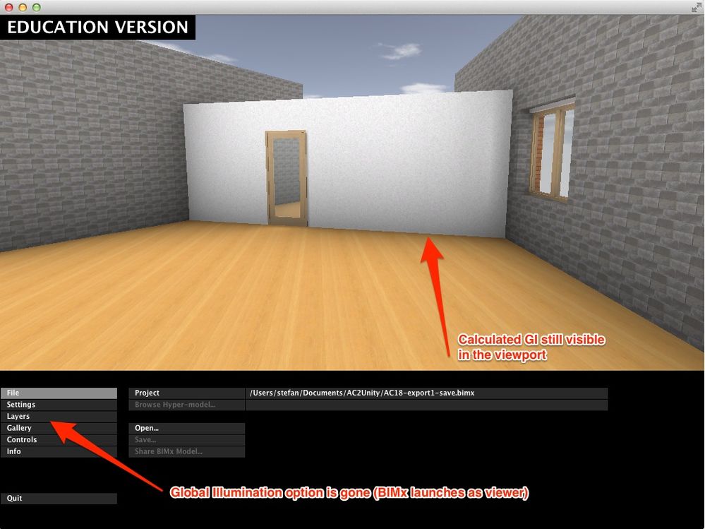

With some further testing: when you export as BIMx in ArchiCAD 18, BIMx directly opens and that provides the GI option.
When you then save as BIMx and reopen, the option is gone. But if you baked the GI into it, it is still there.
Strange...

stefan
And this is what you get when you re-open the file

Hey All,
From version 17 the BIMx license is integrated into the ArchiCAD license. The Commercial BIMx Desktop App can find and use this one license from the keyplug when its started. However the EDU version license can’t be read by BIMx unless it was started from ArchiCAD with the “start BIMx after save” checkbox option. If BIMx doesn’t detect a license it starts in Viewer mode where Save, Share and GI calculation is disabled. That is why you can calculate GI (and save and share) when you start BIMx from ArchiCAD and why you can’t when you fire up BIMx independently.
We are working on allowing BIMx to detect the edu license also when it is started separately.
From v18 you are able to open the 3D content of BIMx Hyper-models (saved via the publisher) with Desktop BIMx as well.
