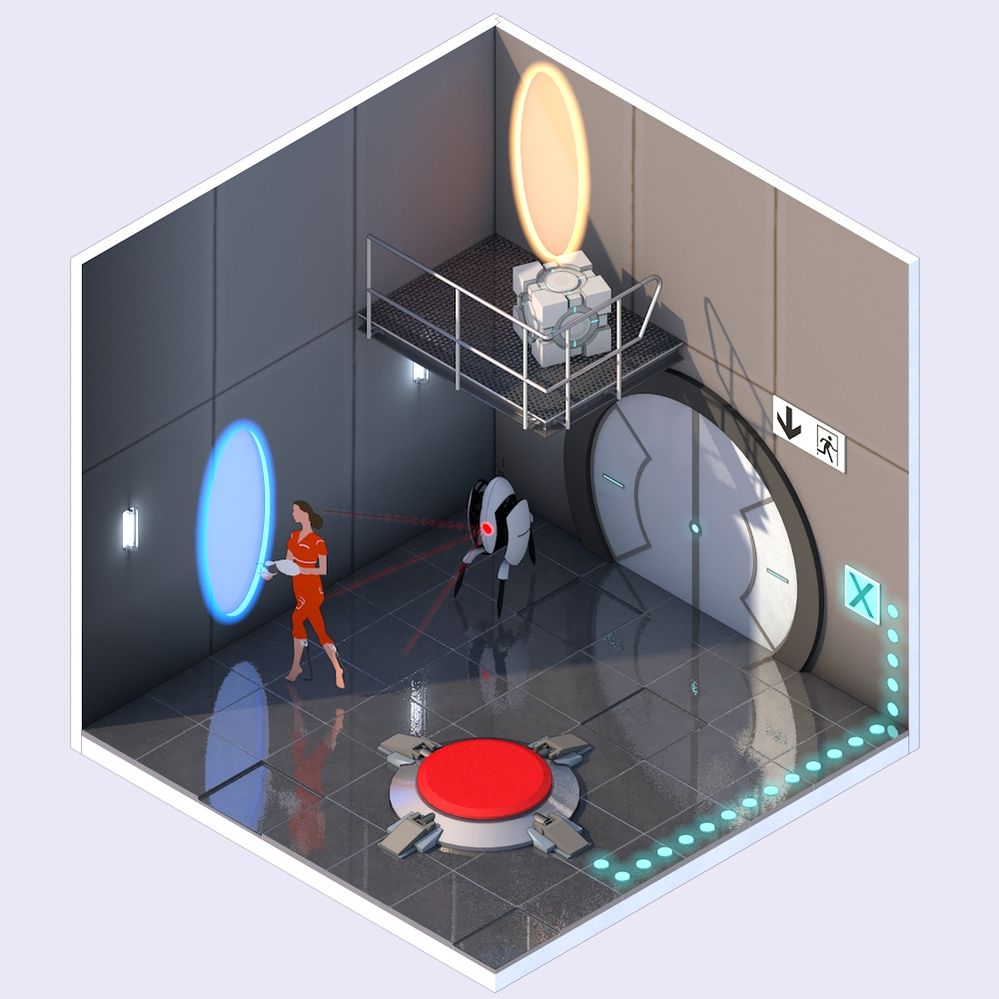

What an amazing job !
How did you do the lasers and the woman? And how did you manage to use surfaces outside the library to be read inside the host file?
Turit
Thank you @C_matsuda.

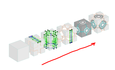

The woman is a plane with texture, I didn't have time to do it anymore in profile manager.
What you see the exit sign, X , and the cube inner core are profiled thin beam, not texture.
Only not Archicad texure is on the wall.  In the .mod file you can place texture or object in the embedded library.
The lasers are sloping beams , with glowing color surface.
The portal are opening, also the floor indentations, and the cube outer shell ( a slab with 15 openings ) 😉

C_matsuda
Uau ! Great Job !
Congratulations ! @Turit
Fantastic. Great use of beams and the opening tool.
ocatillo
Amazing, we’ll done! 👏🏻
SepidehKolahi
Nice
