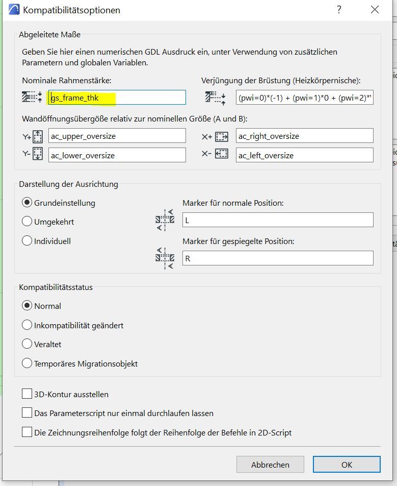

Hi there,
For some reason the zone adds the area of certain doors and not for others. And I want the zone to include doors & Windows.
The swiss helpline said it has to do with the zone not knowing until where it needs to calculate, with doors which have lining. (I'm not sure whether this is the correct term in english)
Now I assume this limit is programmed into the gdl of the door. Does anyone know anything about his?
11 REPLIES 11
Jackpot! Hadn't thought of that.
Don't know what it's called in AC ENG but it's the value in the top left corner.
It was set to "C_" before. Don't know what it means but changing it to gs_frame_thk did the trick
C_ is the old GLOBAL variable for the wall thickness.
