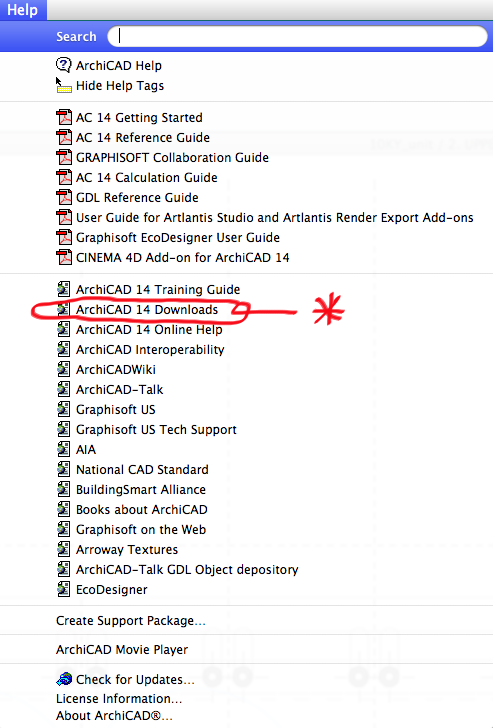

Is there a 3ds in addon for archicad version 14? i have found it only for version 10...
Please help me, and thanks

Have a look here
When in doubt you always have the help menu

Strange - but if you downloaded from the v14 page it should work (even with that message). Have you tried importing a 3ds file?

What does your add-ons manager say?
Nothing there... Someone said to me i should reinstall the latest hotfix... but there is a problem too... i can't reinstal it, it doesn't allow me to do it... it just quits the program...
I'm no add-on manager expert but you have multiple instances of the import plugin (I have a single in and out)
Maybe you could manually delete them from the add-ons folder on your system? - and then re-install ... however I cannot say if this will cause you more problems.

It worked... I delited all previous addins for 3ds and reinstalled the hotfix, and its working now...
