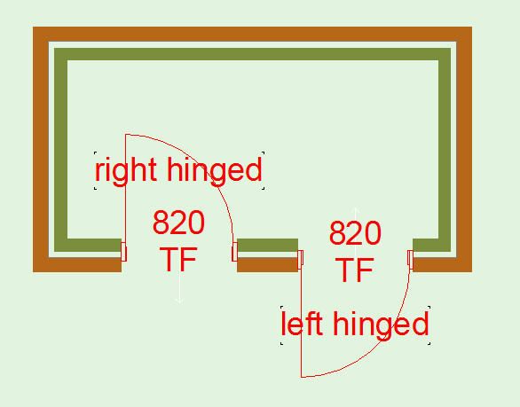

As I have experienced with AC 14 and AC15 the L and R orientation of the door is based on where the opening side of the door swings.
The 3D Front View is always the opening side and the 3D Back view is always the opposite. Now, is there a way that I can set the Front View as a fixed view where this could be the opening side or the opposite of the opening side. So that in my schedule 2d view, i can have an R for door with hinges on the right that swings inside the house (for exterior doors) and still an R for door with the hinges still on the right side BUT swings outside of the house (still for exterior doors). Is this possible?
No the front view is always the side that the door opens into.
It has to be this way so you always know what you are looking at.
You can't have the front view being the opening side for some doors and the other side for other doors as that would simply be confusing and you would never know what you were looking at in the schedules.
The rule is that you pretend you are opening the doors towards yourself.
The hinges are either on the left or the right.
If the door opens to the inside of the house then you pretend you are standing on the inside.
If the door opens to the outside of the house then you pretend you are standing on the outside.
Otherwise what you are asking is that the doors in the attached image are the same hand - which they clearly are not.
