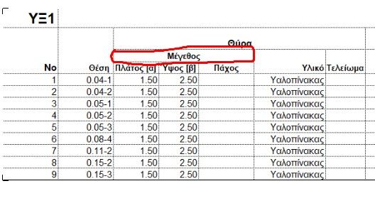

I have watched a few tutorials in the hopes that I would find out how to solve this but I can't. How can I add a row to group some of the columns in window schedule? All I can seem to do is have each row separately..
The first image image shows how the schedule is now and the second one shows in red what i would like to achieve (it's from an AutoCAD file).
Thank you very much.

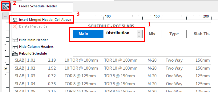

vistasp
  1. Select the headers you need (shift-click)
  2. Click on the gear icon at the top
  3. Select "Insert Merged Header Cell Above"
Result:

vistasp
Result:

HelenE
You don't know how grateful I am to you! Thank you very much!!!
