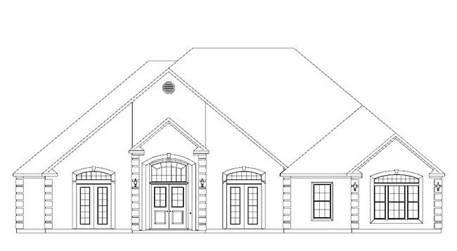

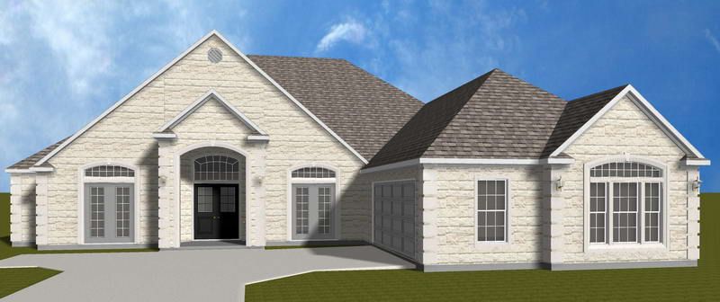

Here are some examples from Softplan how does Archicad compare to these?

a render

For example on the front elevation I had to draw in all the texture and shading. Attached is the actual output from the model. Another thing I wish softplan would do is perspective line drawings with all the details.
I have seen these types of drawings by archicad users but with so many add-on products available it is impossible for me to tell what was done in archicad and what was done in other programs.

Most of my renders I have to import into a paint program and touch up.

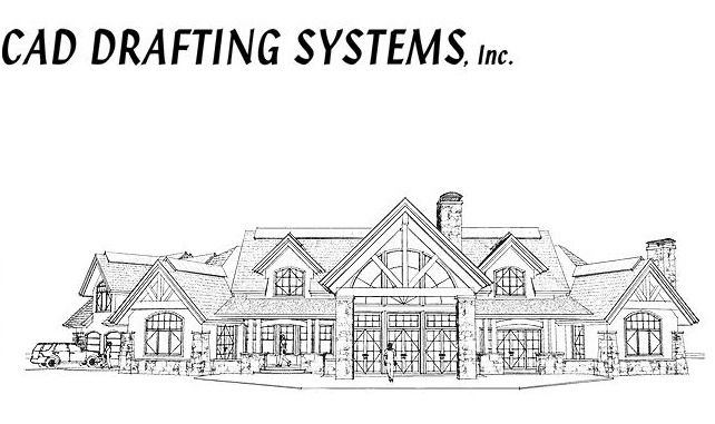

Another example: this persons work was featured in the showcase
Does anyone know if this was this generated by archicad or some other program?
