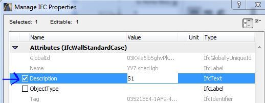

I'll start exporting models for quantity take off soon and I want to tag the parts of the building that still are in the early design phase as compared to the ones that can be used for detailed information. Basically I'm after Level Of Detail.
I tried to use the IFC Description as illustrated in attachment but I can't get hold of it in Solibri Model Viewer/BIMsight.
Any smart ideas?

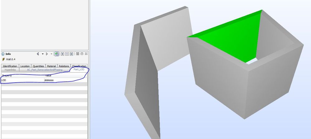

I just found the new version of BIMsight had IFC properties enabled...ok...now BIMsight is working fine but in this very project the builder will use Solibri Model Checker and I can't find any way to get the desired text string (S1="sketch", S2=2approval" etc) to show up and be useful as a filter in SMV.
Very grateful for ideas,
Mats

Me-schmuck. Now I got it in SMV as well. Now I go to sleep.

I added a new Pset instead....as attached.
