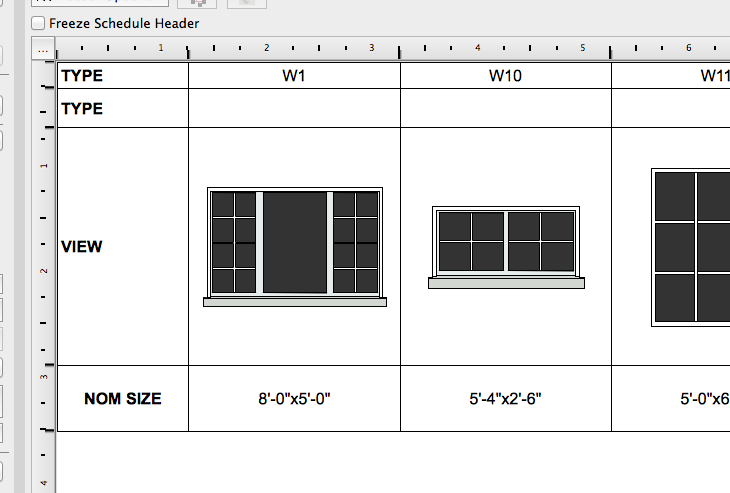

Is there a way to lighten the glazed areas in a schedule so that the window muntin bar patterns show better?

3D Window Transparency settings used to affect the display of windows in the schedule, but I think that's no longer the case.
Have you been playing with your fill types in this project by any chance? In particular has the Air Space fill been replaced by a Solid/Foreground/Background/100% Fill?
Maybe try starting a new project from the defaults and test the appearance there to see if you're getting the same issue?

I found the solution. It is a setting under model view. Change the setting while the schedule is open.
