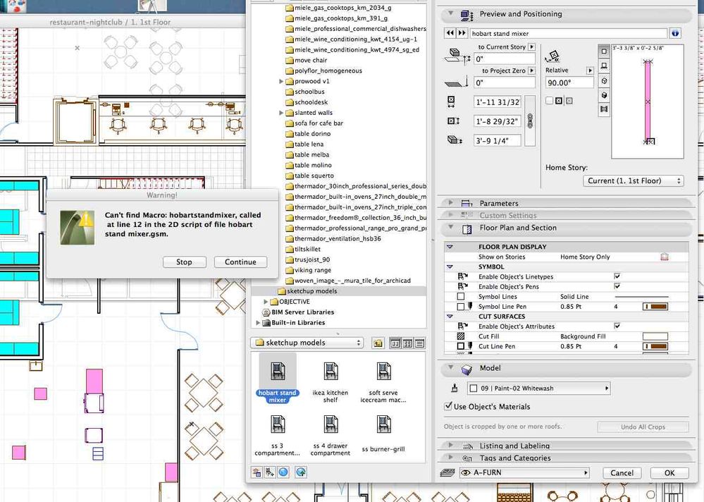

I went to Trimble warehouse and downloaded several sketchup models of objects for my building. I opened them and saved them as a new object placing them in a folder in my library. When I go to insert them - I get an error asking me to open the file and look for error in the scripting? I just want to insert the bloody thing in my model for walk-thru viewing.

Try dragging the .skp files right into Archicad. Make the saved Archicad object from within the Archicad file.
