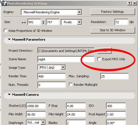

I would like to know where can I download the "export" plugin from AC10 to Maxwell Render 1.1 ?

the plugin or addon in the download area (maxwell`s web page) is for render an image from inside AC10.
I need the addon to SAVE a project made in AC10 from the 3D perspective window like AC9 does.
in the settings of the AC10 plugin, next to the scene name box, is the setting to export the mxs file only.
what do you mean with "in the settings of the AC10 plugin" ???
If you have the maxwell plugin installed into archicad 10, Its in the Photoredering settings
Thanks, JNT !
