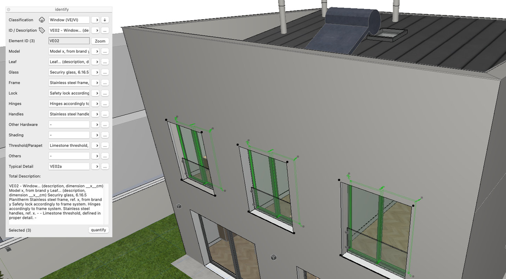

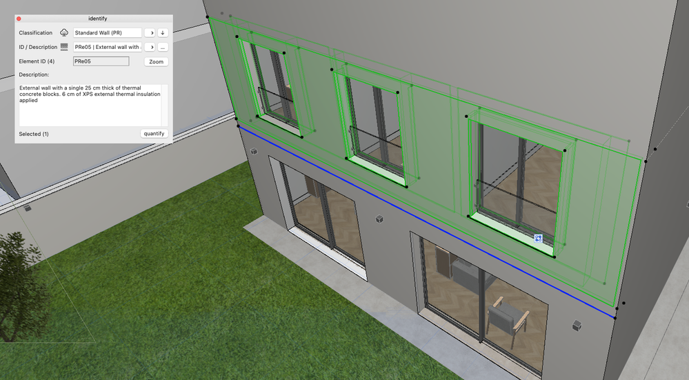

  • Identify — once each element is linked to the classification system, it keeps the native Element ID and Description synchronized with the attributes or properties relevant to each element type.
  • Quantify — once each element type is linked to the Work Breakdown Structure (WBS), it builds the Bill of Quantities using the ID and descriptions Identify has already generated automatically, with the option to add extra information relevant to the BoQ. Each item number is also tied back to its chapter number in the WBS and to the element's Element ID. The final quantities are calculated according to the unit of measurement chosen for each item.

  • Element ID synchronization: The native ID follows the element's Building Material, Composite, Complex Profile or Property, so the ID always reflects what the element actually is.
  • Element ID as a Type: A single Element ID can carry multiple associated properties, and any change to one of them is automatically applied to every element sharing that ID.
  • Dedicated Classification and Properties: A simplified classification system, built to work hand in hand with a set of dedicated properties.
  • Quantities by shared ID: Values summed across a selection or across every element sharing an Element ID.
  • Native storage: Everything is written to standard Archicad classifications and properties, so it stays readable by schedules, filters and IFC export.
