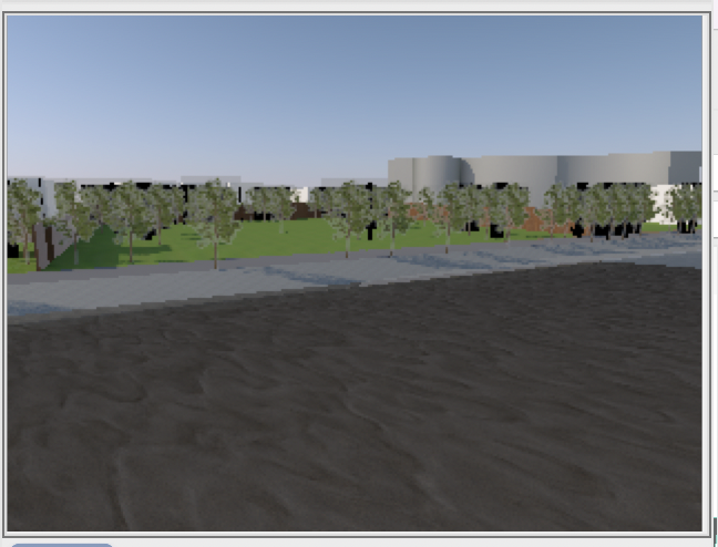

Hello everyone,
I am a beginner Archicad user and I need help with rendering. I would like to render water - river 025 surface, but it came up grey and black. Does someone have the same issue?
I tried these options:
- ticking transparency
- ticking refraction
- ticking environment
- reducing refraction rate
None of them worked. Maybe I should change foil?
Photo attached and linked here: https://doc.clickup.com/p/h/4ezjq-47161/5109df736bddded
Thank you in advance.
Szilard

Have you tried increasing the Opacity of the material ?  My thoughts are that you have the material too transparent and therefore you are seeing through the water to whatever is underneath.

Hello Tony,
Thanks for your reply. I will check it this week and reply here. Hopefully, It will help.
Take care!
