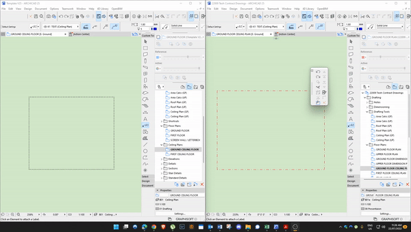

Hi all.
For some reason I cant assign a label or select the slab other than selecting it from its edge only.
The GIF explains this. The right side is working on a previous job.
The left is not working in the template.
What is the cause of this?

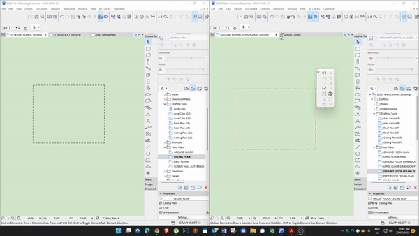

I thought it may be the Quick Selection Tool but with jobs side by side I hit shift and it works with the right side job but the shift command dosnt work on the other job.
As you can see in the new GIF the magnet disappears.

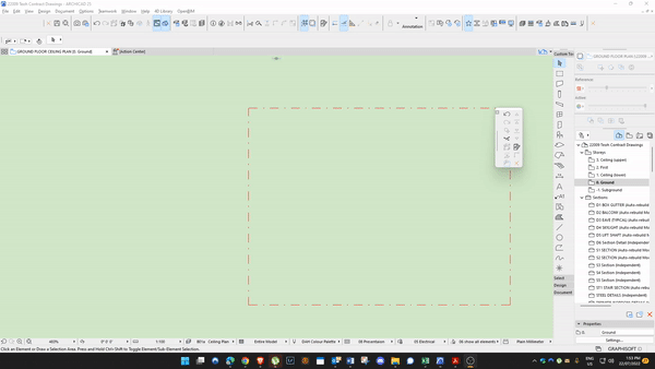

Hi Barry, the slab is on a different storey but the slab is selectable with the selection tool as you can see below.

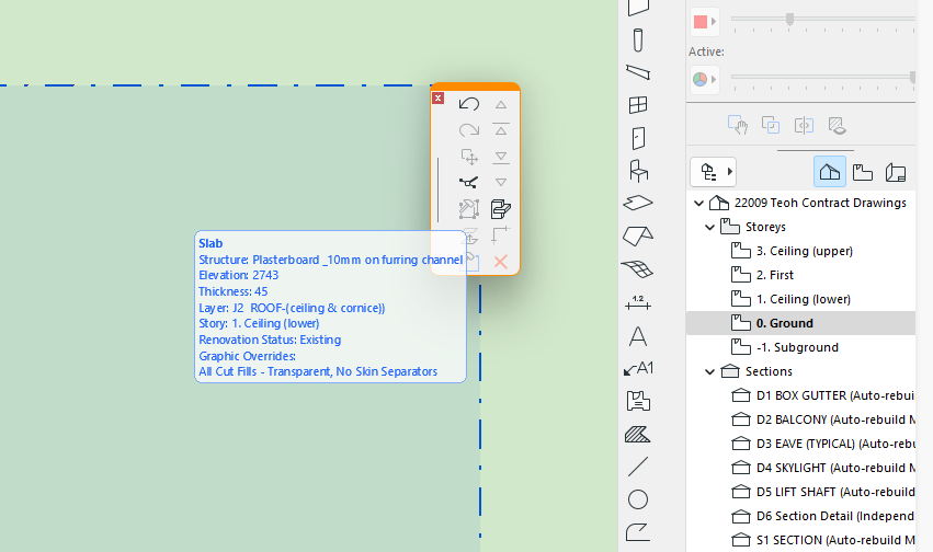

Yes it is still selectable - but not with quick selection.
For me, if the slab is on a different storey, the quick selection (magnet) does not work on the surface of the slab.
I have to select it by clicking on the edge.
The same for placing labels.
This is the problem you are experiencing, is it not?

I just had a play.
If the slab has a cover fill and the cover fill is set to show one storey down (or up), then you can select the slab on the storey above or below where it is placed with the quick selection magnet.
No cover fill, then quick selection only works in the same storey as the slab.
