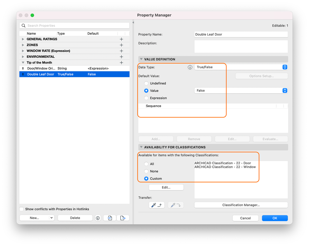

Open Property Manager from the Options menu.
Create a Property group if needed.
Create a new Property called Double Leaf Door with True/False data type.
Set its availability for Doors (and optionally Windows) based on the relevant Classifications.
Set the default value of Double Leaf Door to false so elements behave as single‑leaf by default.

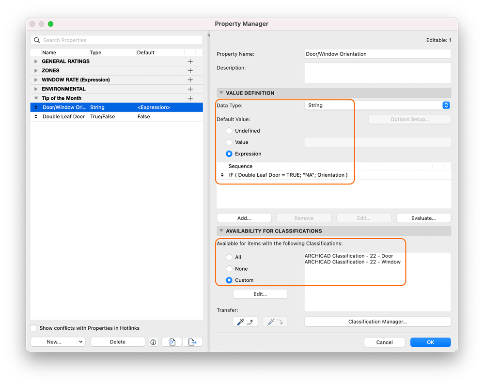

In Property Manager, create a new Property such as Door/Window Orientation with String data type.
Enable an expression for this Property and enter a conditional formula similar to:
IF ( {Property:Tip of the Month/Double Leaf Door} = TRUE; "NA"; {Property:Window\/Door/Orientation} )
Ensure that the expression references the correct Property group and the existing Orientation parameter of the Door/Window tool.
Make this Property available for Doors (and Windows if used in the same Schedule).
With this configuration, the Property returns “NA” when Double Leaf Door is set to true and otherwise passes through the original “R/L” orientation value.

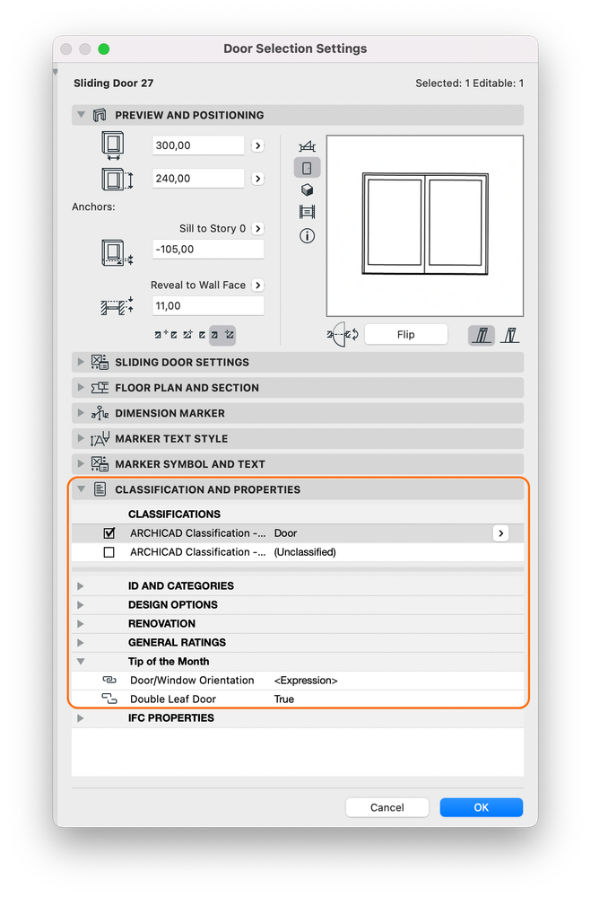

Open Door Selection Settings for each door type that should be treated as double‑leaf.
Locate the Double Leaf Door Property in the Properties panel.
Set its value to true for these doors so they are recognized by the expression in the Schedule.
