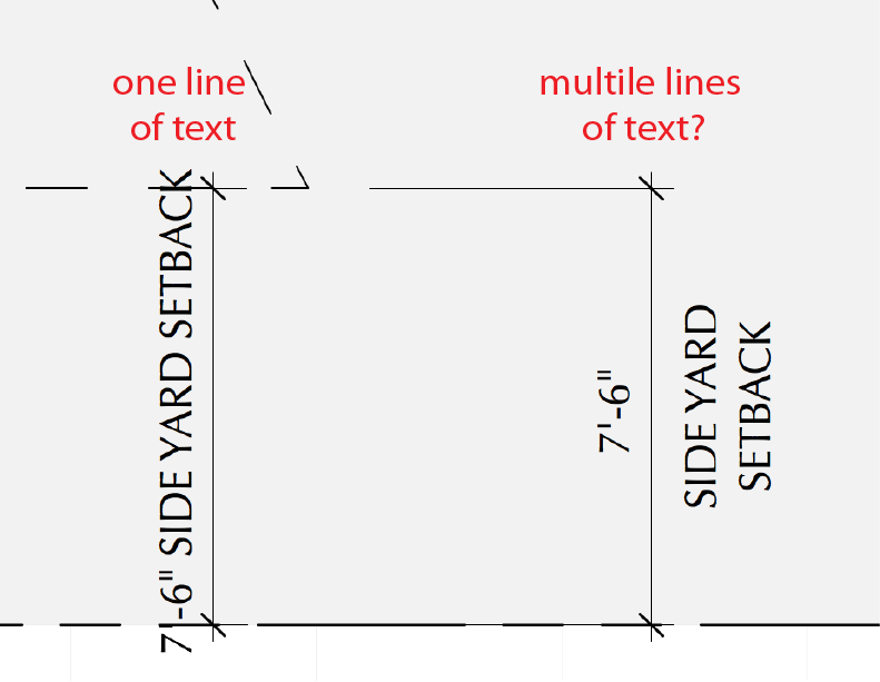

I would like to create multiple lines of text in the dimension string. How do I do this with out placing a separate text elements under the dimension? Please see the attached image of the example how I would like it to look.

You can't unfortunately (although I haven't checked in 15 but I'm pretty sure there is no change there).
You will have to place separate text.

Nope -- not in AC15 either.

try /n!
Chris wrote:
try /n!
That doesn't work unfortunately.
Hello,
The line feed is \n, might work that way.

Juha wrote:
Hello,
Regards, Juha
It doesn't work no matter what you do.
I haven't tried everything I can think of in 14.
Haven't tried in 15 but can't imagine it will be any different.
