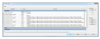

A silly question but is there a way to be able to select the type of door clearance option required depending on the opening direction of the door and the direction of people approaching it?
For example in Revit this can be created in a door family and providing options for us to choose which one applies.
The minimum requirement overlay in the door gives only 1 option and each time we will have to assess the situation, going back to the Standards and then change the input of the minimum required distance, and if this door changes in direction or location, then everything has to be re-looked at, which feels very onerous to me.

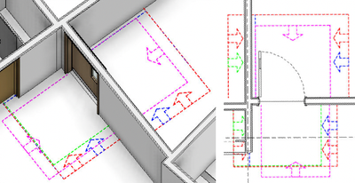

we had an object that is no longer compliant to the current AS 1428.1 (2009) standards, even less-so to the soon to be updated 2019 (?) one.
my thinking of it was to save one Favourite for each approach type, including the Sliding Door approaches.
I don't think this would be feasible with the current Minimal Space setting. We'd end up having multiple favourites for one door type just to have a varying Minimal Space layout. that's what -- 8 approach types for a single swing door? minimum? not exactly user friendly.
how we've been approaching it in the office is, i've manually drafted the typical minimum door approach requirements that we use (typically an 850 clear opening / 920 door leaf):
the layers are correct & can easily be copy/pasted from the Worksheet into any plan floor plan without having to toggle layers.
it's not ideal, only because nobody in our office knows GDL, so this is our workaround. it's compliant & can be easily updated once we get our hands on the updated standard.

Yes I agree with you - that's what we are doing right now - I still find it fiddly though as for example we need to check both sides and if in the corridor it's consistent but inside the rooms people can approach from different directions due to different layout then we have to do the other side individually - as originally I was trying to see if we can combine both sides and have them as minimum numbers of types as possible.
I'm new to Archicad and not familiar with GDL at all - I was able to do it in Revit though as it seems to offer more flexibility when it comes to situation like this.

There is a way it’s called Minimum Clearance and is defined in the settings of each individual door. The display of it can then be controlled by model view options. However, there is only one option and there is also minimal space for objects too and it’s either all on or all off it can’t be displayed per individual element. I submitted a wish for this to be improved.
