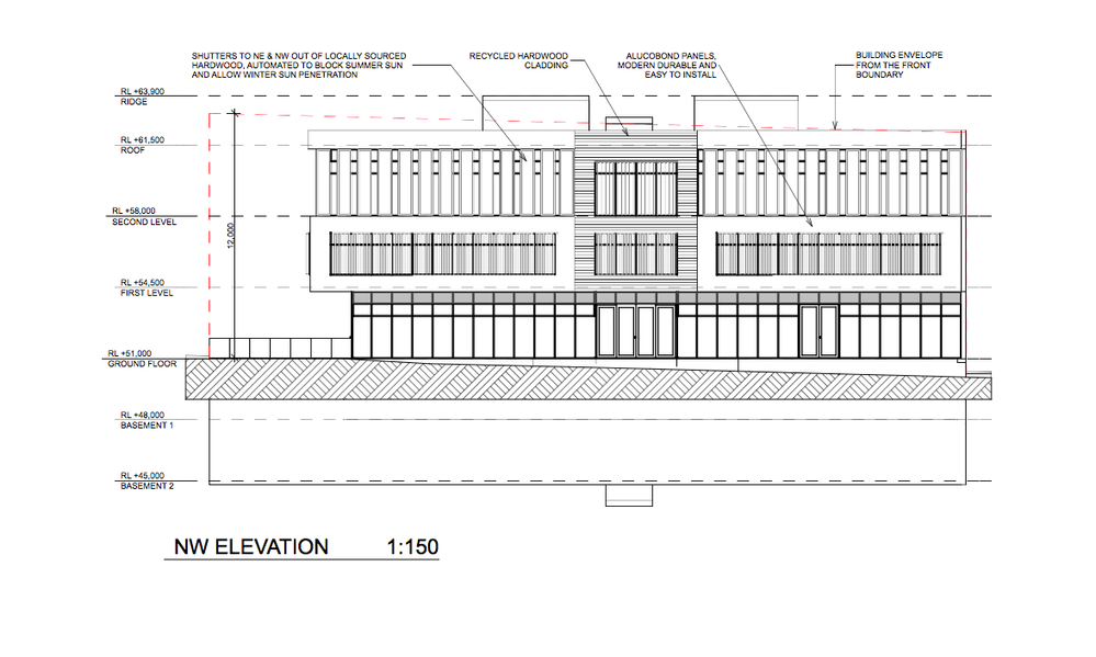

Hi, I would like to know if I can change the line work from solid to broken lines in an elevation to indicate that those elements are below ground level. I have attached a drawing to help explain. Any advice appreciated.
Cheers
Scott

A bit dated... but here is a workaround:
CREATE A MASK
Marc Corney, Architect
Red Canoe Architecture, P. A.
Thankyou Marc, thats works well.
