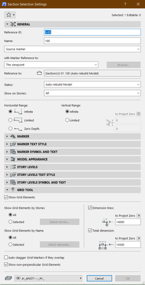

Uunder the section or elevation settings you can unchecked the auto-stagger. Hope this helps.
