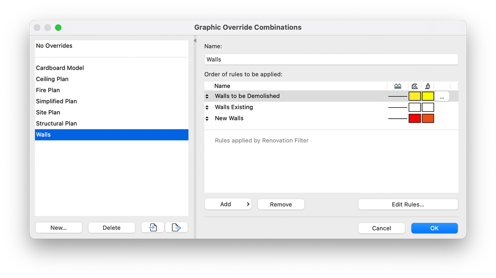

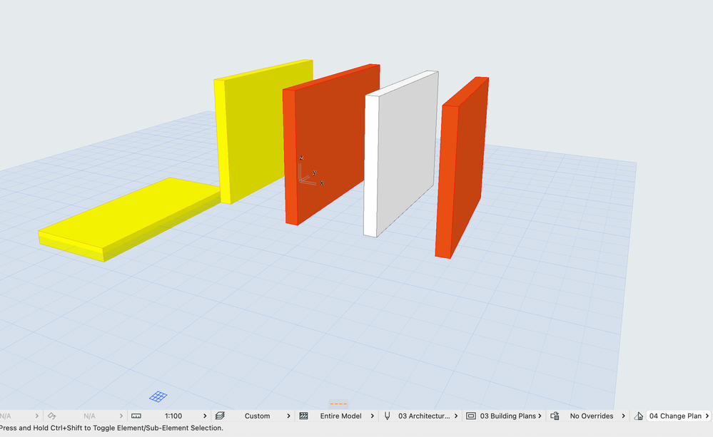

I agree with Filip. You can achieve the desired result by creating a new Graphic Override Combination that will replicate the Renovation Filter settings, except you establish only walls as element type criteria. Please check the screenshots below:
Graphic Override is set to "Walls" and Renovation Filter to "Show All Elements"
Graphic Override is set to "No Overrides" and Renovation Filter to "Change Plan"
Create a new Graphic Override Combination with new rules that replicate the Renovation Filter (except only for walls)

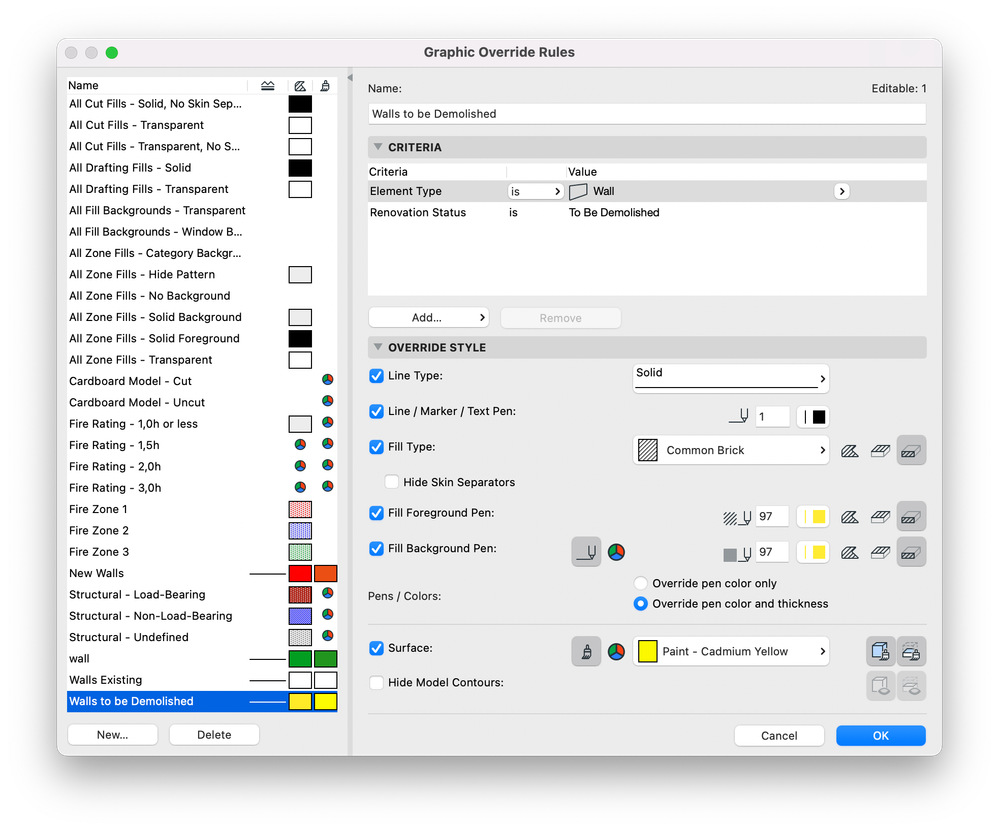

Example of rule you'd need to create
