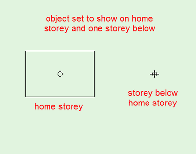

Trying to create some new basin object that have the plumbing point attached. Trying to get the plumbing point to display on one level below, so if the basin moves than the plumbing point in the slab plan will go with it.
At the moment they are modeled separatly and grouped. I've tried to save this out as an object but it hasn't worked. Will this have to be scripted into the object?

How good are your GDL scripting skills?
You would need to script your object so it is sensitive to the storeys.
i.e. so if it is being displayed on a storey that is not the object home storey then it would show only the plumbing connection.
Then you can set the object to show on home storey and one storey down.
It should display the basin on the home storey and the plumbing fixture on the storey down.

tomyg want the basin to show differently on the home storey and the storey below.
Something like this.
I am lazy - I haven't modelled a proper basin.
Here is the code for the 2D script to do the above.
LINE_TYPE "Solid"
if GLOB_CH_STORY_DIST = 0 then		!!home storey
	RECT2 -0.3, -0.2, 0.3, 0.2
	CIRCLE2 0,0,0.02
endif
if GLOB_CH_STORY_DIST < 0 then		!!above home storey
	LINE2 -0.04, 0, 0.04, 0
	LINE2 0, -0.04, 0, 0.04
	CIRCLE2 0,0,0.02
endif

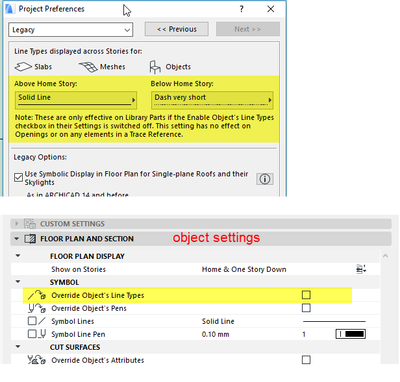

Note it will take on the storey line types as set in the Project Preferences unless you turn off the 'Override Object's Line Types' in the object settings.
