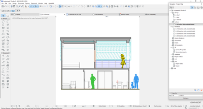

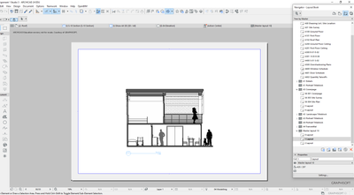

Can anyone tell me why I'm getting no colour on my layout/section here? Not quite sure what I'm doing wrong, still a bit new to Archicad.

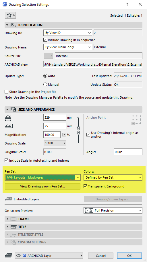

Have a look at the 'drawing' settings for the drawing you placed on the layout.
What pen set is it set to use?

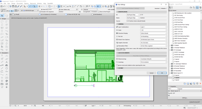

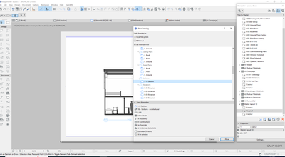

The Pen set is Modelling, I linked an image on the settings when placing a drawing and also what the colour on the section looks like.

Barry meant the settings of your drawing object (ctrl + t) on your layout. Not the settings of your drawings
on this help page look for 'Pen Set'
