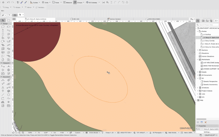

Step 1: Draw the wall outline as drafting geometry 
  • In the floor plan view, activate the Circle tool, select the “Ellipse” geometry method in the Info Box, and draw an ellipse.
  • To work with only half the ellipse, draw a straight line through the center along the major axis, and trim the half you don’t need
  • Offset the half‑ellipse by the desired wall thickness, connect the ends of the inner and outer curves, and consolidate the linework so you get one clean closed polygon ready for the Magic Wand.
Tip: Place this construction geometry on a separate “Guides” layer, so you can hide or lock it later without affecting the actual walls. 
Step 2: Create a polygonal wall using the Magic Wand, and place doors and windows freely along the curve.
  • Activate the Wall Tool and switch to the Polygonal method in the Info Box.​
  • Magic‑wand (space‑click) the closed polygon to generate one continuous polygonal wall that follows the elliptical shape.
  • Place doors and windows along the curved wall wherever needed to define openings around the ellipse.
Tip: Before using the Magic Wand, set wall height, structure and reference line position so you do not need to adjust those parameters on multiple walls later.​
The result
With this workflow, you create a continuous elliptical wall, and can place openings freely anywhere along the curve.​
