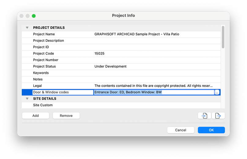

  1. Create a Project Info field for the lookup table
    Open File → Info → Project Info and create a dedicated field and name it, for example, Door & Window codes.

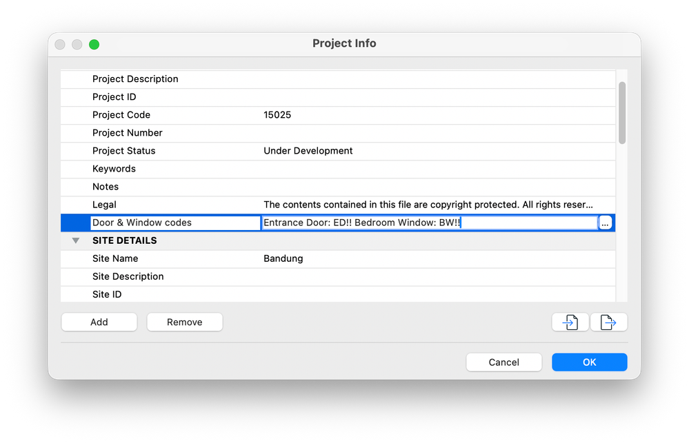

  2. Add the code pairs as plain text
    Enter one item per line, pairing each door or window Product Type with its short code. For example:
    Entrance Door: ED!!
    Bedroom Window: BW!!
    Each line follows the pattern:
    Key: Value!!
    Note: The !! characters act as a right-hand delimiter, marking where each returned value ends. Line breaks are optional, but they make the lookup list easier to read.

    Make the abbreviation property available for doors and windows. The Product Type must match the Project Info entry exactly:
    Project Info: Entrance Door: ED!!
    Product Type: Entrance Door
    Result: ED
    If there is no exact match, the expression returns the original Product Type.
