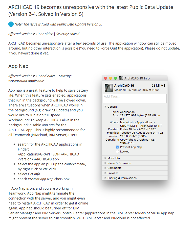

Are you supposed to have APP Nap disabled for ARCHICAD 19 or 20?

yes, disable this.

Aaron wrote:
yes, disable this.
You can disable AppNap completely with
defaults write NSGlobalDomain NSAppSleepDisabled -bool YES
Tested with OS X 10.11.6
